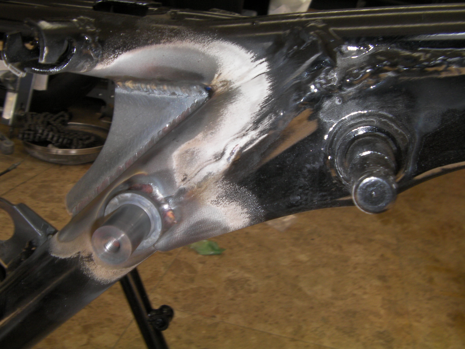

- Posts: 7442
Re: HELP JUST BROKE.....
08 May 2012 16:55
here is a picture to show you what zed1015 was talking about.
(this is where extra shock mounts have been added to "laydown" the shocks.)
the same method could be used to repair a broken shock mount.
