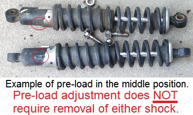

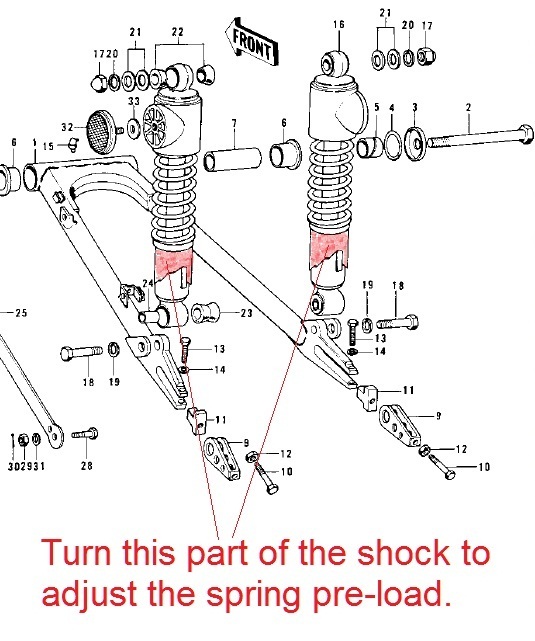

As to the shocks --
Could perhaps increase spring pre-load on the shocks.

Last edit: 18 Apr 2012 15:11 by Patton.
