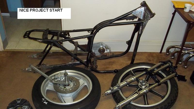

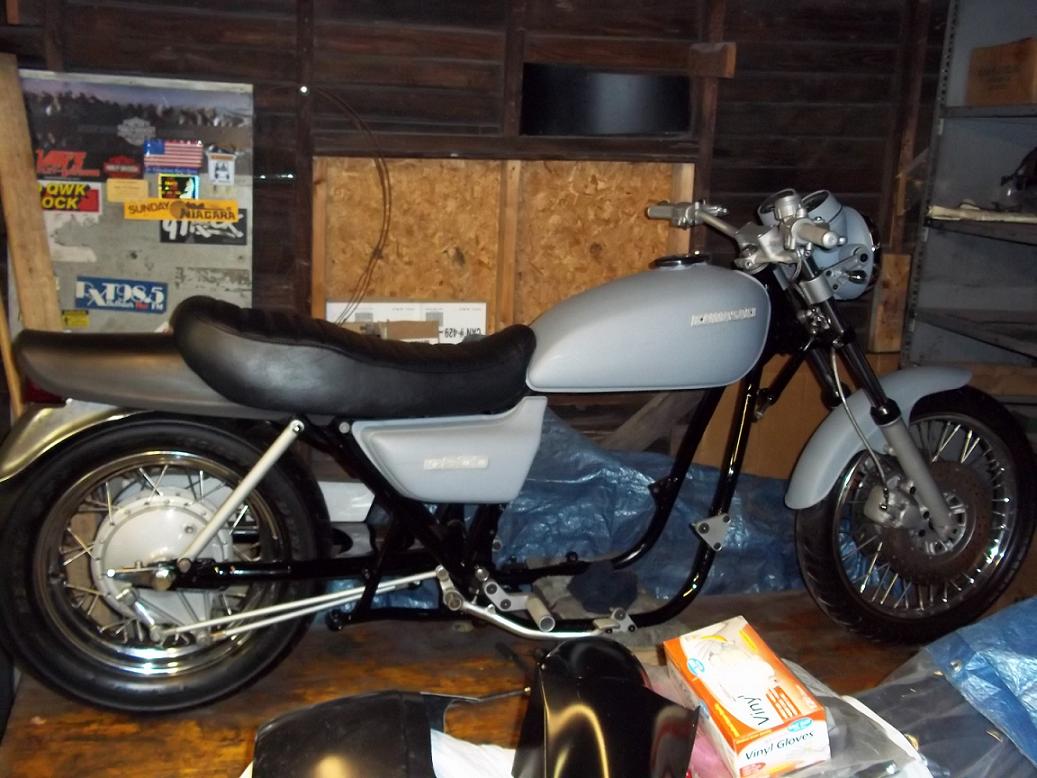

Two suggestions, capt'n:
Attachment kawaskaki-kz750.jpg not found
Attachment long_2012-04-18.jpg not found

Now those are stretched :laugh: :laugh:
I like the first picture.
Yes, only way is to have some one build it.
Plus rake the neck a little.
You want a suspension? or a hard tail? dragbike style?
Here is the classic old school KZ dragbike look.
