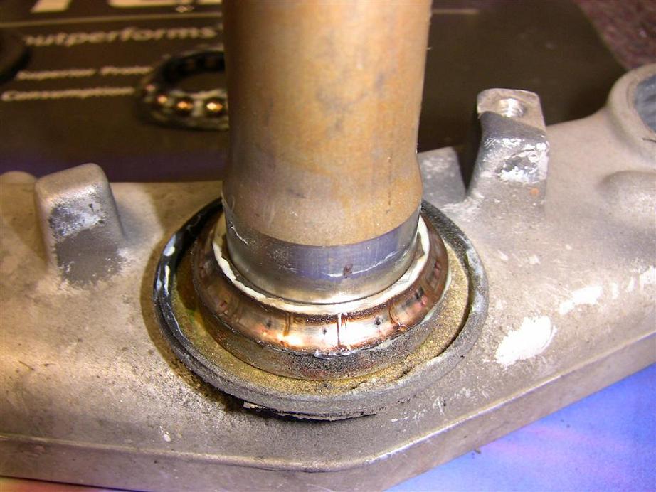

Maybe new roller bearings were installed, but with same old worn dimpled races left in place. :pinch:

If not already done, could try to compensate by setting the spanner nut slightly too loose, in hopes that subsequently tightening the head bolt will snug things up enough to remove the play and leave the free handlebar swing from side to side.
Objective is for the handlebar to swing from side to side (stop to stop) as freely as possible, without having any play in the bearings.
Might be able to feel the effect of dimpled races when turning the handlebar from side to side.

May discover an assembly error, because am pretty sure that tightening the stem head bolt should not further tighten play in the bearings as determined by setting with the stem locknut.
Just guessing, but maybe the fork tube clamps were too tight during assembly of the steering assembly, or a bearing race isn't correctly seated, or a part is missing, or a washer is flipped, or whatever.

Well, it seems the mechanic..and I use that word loosely...overtorqued the steering head bolt, deforming the lower bearings.
Replaced.
