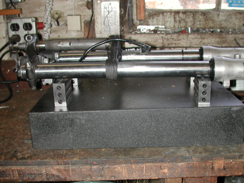

- Posts: 7442
Re: Diagnosing handling problems. Pulling my hair
20 Apr 2012 10:01
it is pretty sound info.
i generally look em over pretty good and use some straightedges across the legs and stuff to eyeball and insure i think the wheel is square with the bike.
or pull em off and get out the surface plate and dial indicators. :whistle:
