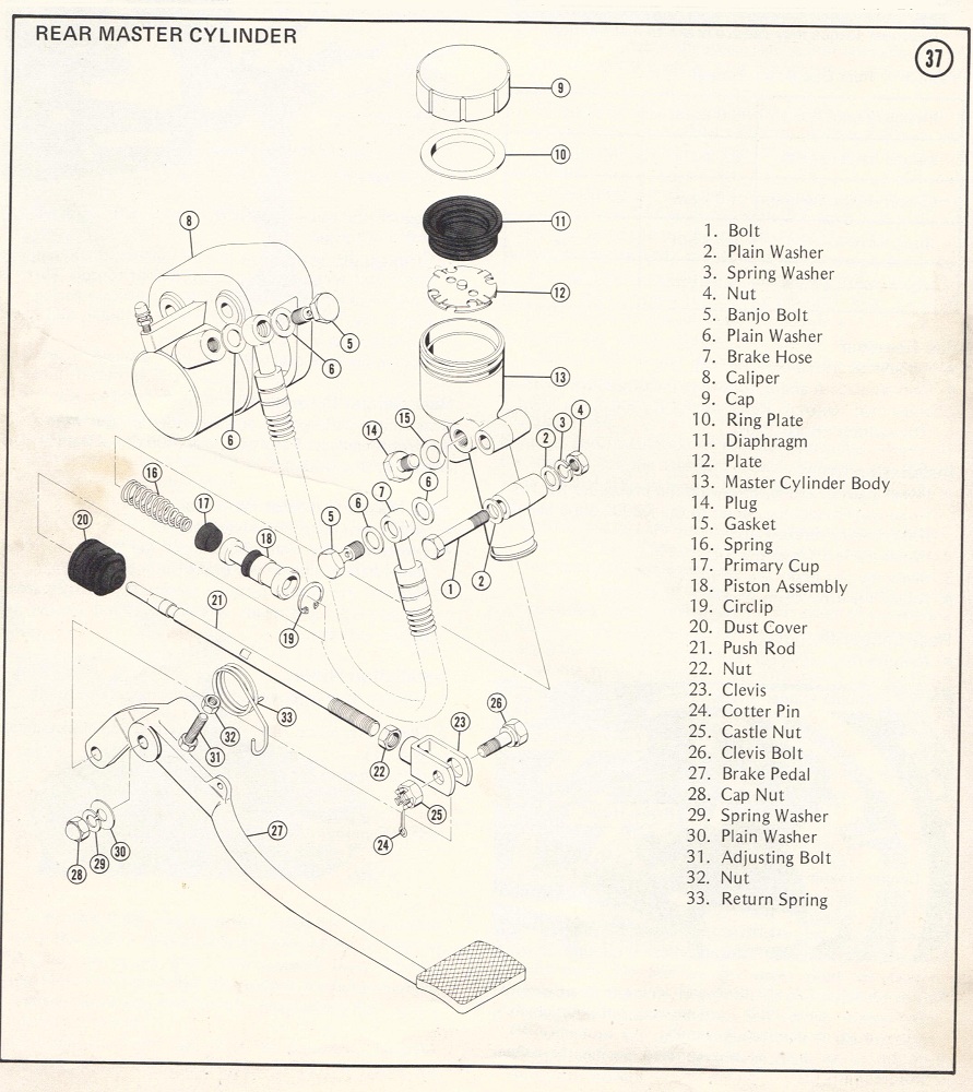

In the following rear master cylinder diagram from 1976 KZ900-B1 LTD FSM, part #12 is located on the reservoir floor.
Note that the reservoir is cast as a permanent non-removable component of the master cylinder.
Am uncertain but guessing that the leaking master cylinder in question is either a round barrel style or the trapezoid style.
And also guessing about whether the reservoir is removable, and whether something like part #12 might be blocking visibility or access to some screws that perhaps attach a removable reservoir to the master cylinder.
Might be wrong, but doubt that a non-accessible gasket would be included in the design and manufacture of the master cylinder, between the reservoir portion and main body.

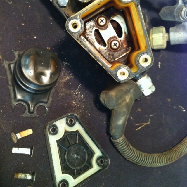

I found the two screws on the inside of the reservoir a long time ago, and attempts to remove them only yielded them starting to strip. They refuse to budge. The MC is not leaking from the diaphragm. On the trapezoidal MC, there is a clearly marked border where plastic meets metal. While it makes no sense that a gasket here wouldn't have a replacement . . . it is definitely seeping from that location, and it looks very much like a gasket from what little of it I can see. In particular, the reservoir is definitely NOT cast, as someone previously wrote. Certainly part of it is, but there is a whole lot of plastic going on there too. Side note: the interior of mine looked just about exactly like the picture shown . . . nice and dirty and nasty. The leak prompted me to do what should have been regular maintenance which I had been avoiding for about a decade now.
The only paint it trashed is all the paint on the cast part of the MC. It hasn't damaged the chrome handlebars and doesn't drip onto anything below. It's more of an annoyance than anything else. I may just use some cash for a NEW mc . . . I definitely agree to avoid buying a 30 year old part that will break next year.
I appreciate all the replies. At this point, my game plan is to buy some sort of sealing agent, and after drying the outside of the reservoir thoroughly, I will apply a nice bead around the entire perimeter where the plastic meets the metal, and I'm guessing that as long as the agent is resistant to brake fluid, I'll be ok. Any thoughts on good agents in addition to the mentioned one early in the thread? I'll go shopping tomorrow.
