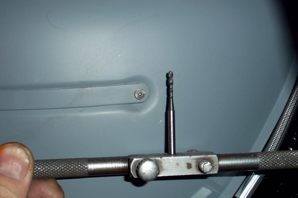

I had one that was broken off, flush. I filed it flat, center punched it, and drilled it out with a LH 3/32 drill, it actually worked...
