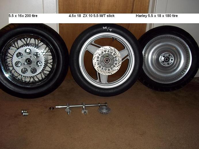

09 Mar 2012 15:44Good Fortune!
- Posts: 18564
- Thanks: 2103
Re: 82 KZ1000 Rear 18" spoke wheel?
09 Mar 2012 15:56Good Fortune!
