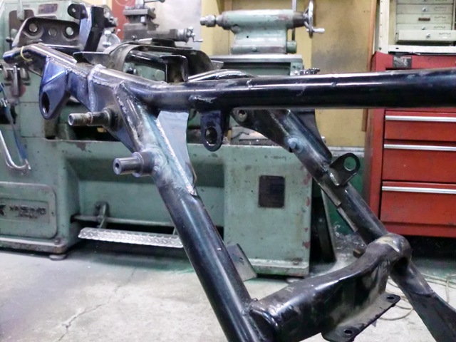

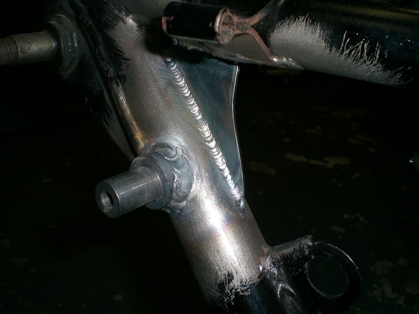

here is a close up of one installed.all these pics are from sanctuary in japan.
they go all the way through the frame tube and get welded on both sides,thus bridging the tube and maiking it stronger than it was to start with.if you just welded the stud to the tube and did not extend it all the way through you would tear it off the frame in short order.
here is another pic.

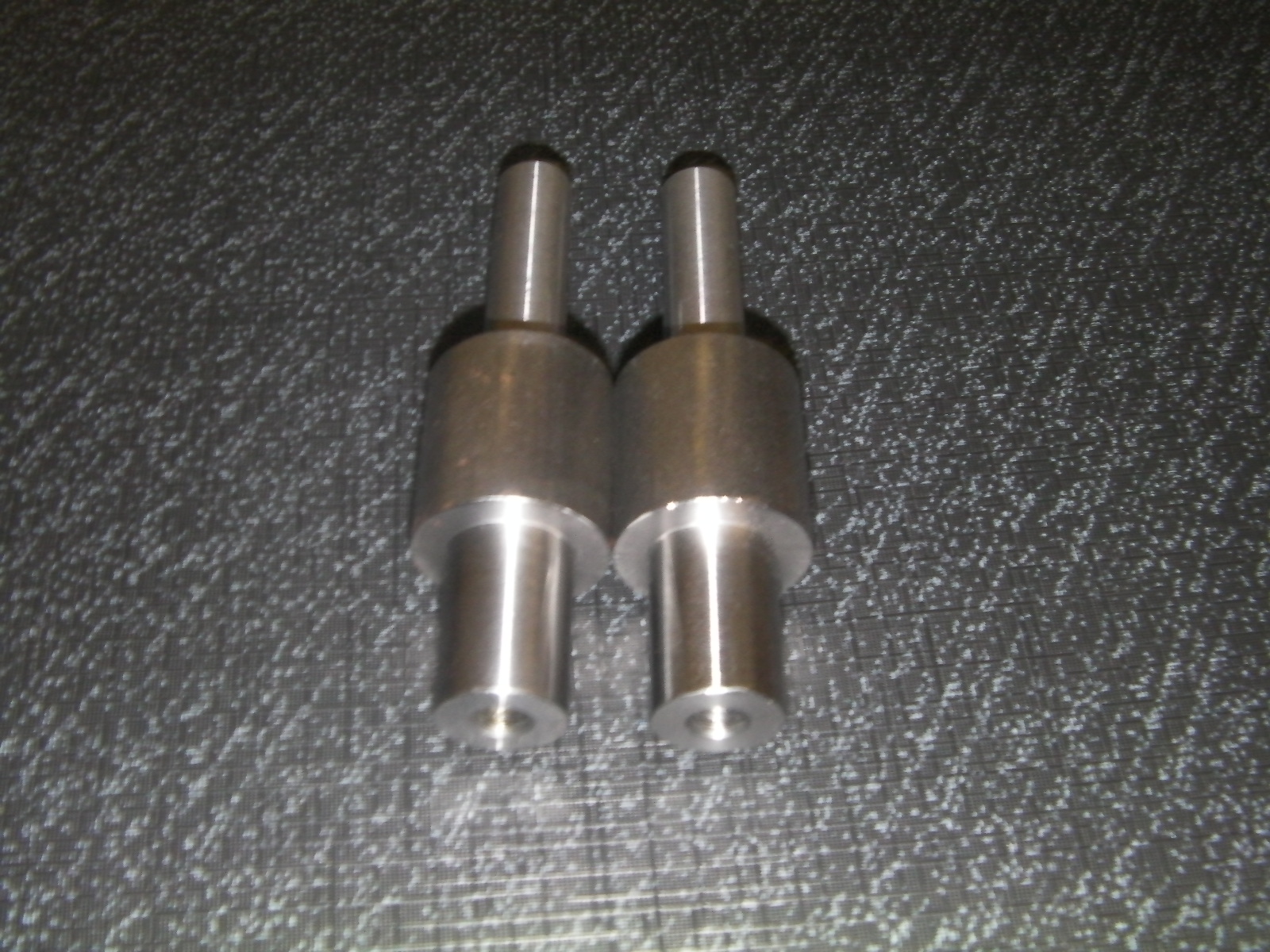

here are the studs themselves

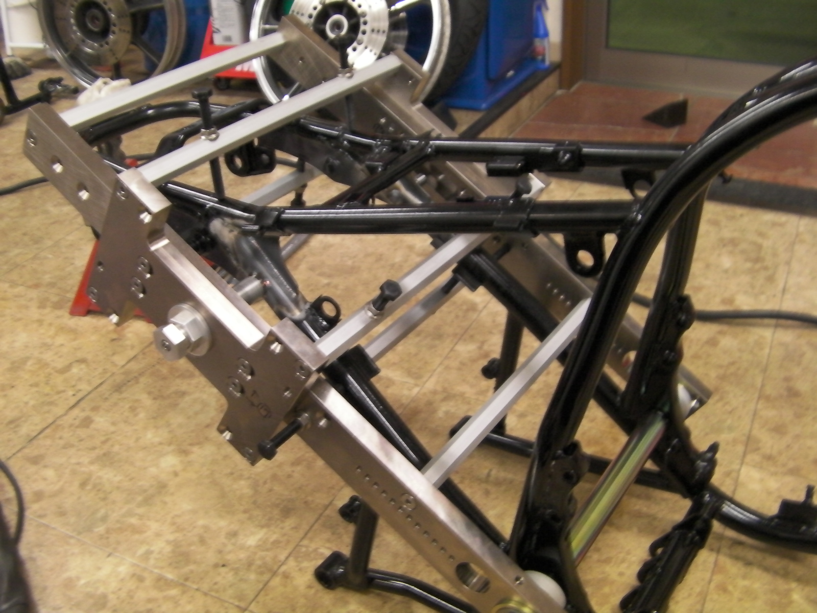

here is the jig they use to properly locate the studs on the frame.
i hope this helps.

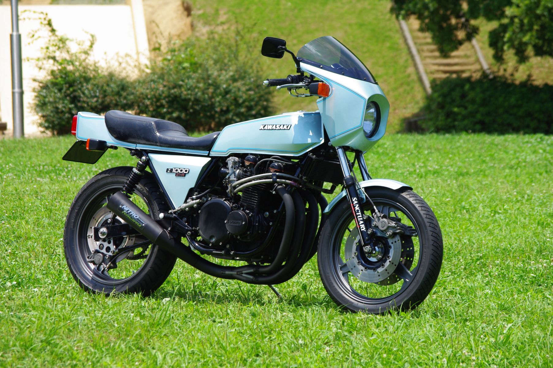

I was just over at sanctuary checking out the Z1-R's, is it just me or is the silver mist blue bike missing the cam plugs on the head? I zoomed in pretty close and I don't see them, just looks empty.
Les
Les
76 kz 900 turbo
77 LTD 1000 turbo
2 78 Z1R's
72 H2
76 kz 900 turbo
77 LTD 1000 turbo
2 78 Z1R's
72 H2
- Posts: 7442
Re: Top shock mount
01 Mar 2012 18:49
sorry for the thread jack. :whistle:
which sanctuary site were you at?
the one silvermist blue z1r pic i have from them ihas some copper/bronze kinda colored aluminum end caps.
if you make it big enough you can see the machined lip around them.
