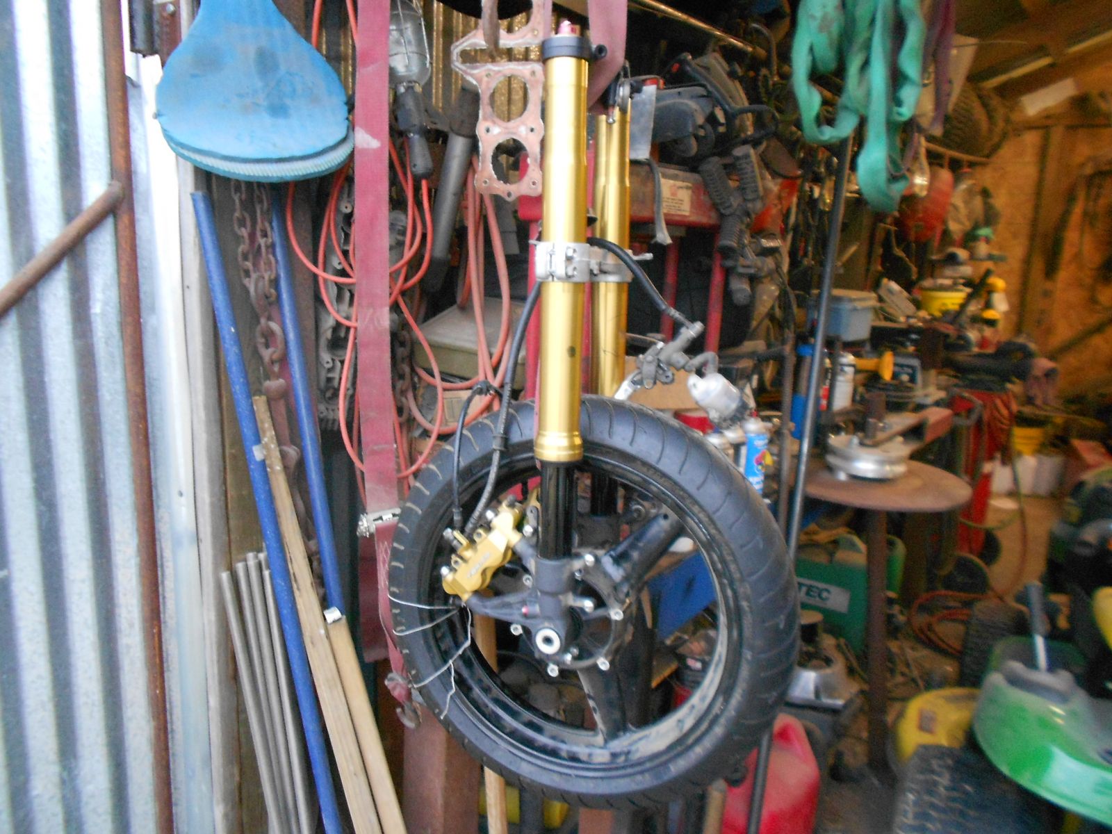

wondering if these forks would work on a 1983 gpz 550, if not are there any suggestions to make it as painless as possible, i'm going to buy the forks and have a local shop install them.....so obviously the less fabrication that is involved the cheaper it will be, thanks!!

if you can't get some conversion bearings from all balls you will have to do a stem swap and then you just use the factory gpz bearings.
i have the same front end that i am currently converting for my z1r.i am swapping the stem for a kz stem.
but i had to be a smartaleck and use a r1 front wheel so it would match my rear wheel.which adds even more headaches :pinch: .

awesome, so if i use the gpz stem i wouldn't have to source any other parts other than that front end, and a wheel correct?

yes if you re-use the gpz stem then you buy replacement bearings and bolt it on just like it was the gpz frontend.

What size bearings would I need? And where is a good place to buy them.....actually I checked out all balls but I'm a little confused as to which kz 550 model corresponds to the gpz 550 a,c,f or h???

Are you planning on getting a wheel from the GSXR also? Not sure how much more work it will create to try and use your existing hub/axle/brakes/wheel... The GSXR wheel/hub/axle/brake combo would make the swap easier, I would think.

Yes I will be getting a gsxr wheel combo
