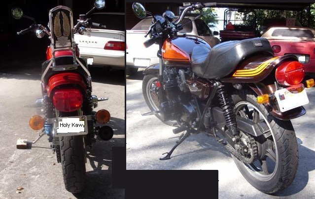

- bountyhunter
- Posts: 7246
- Thanks: 338
Re: 1980 Kz440 ltd sprocket size change
21 Feb 2012 05:16
I recognize the backside of a KZ750 twin over there to the right with stock exhaust...... takes me back to when mine was new.

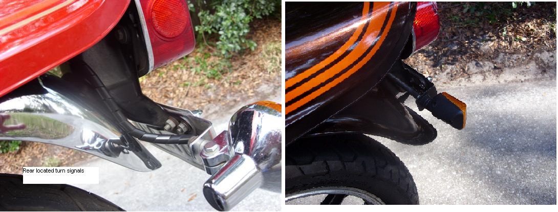

- hypnohio
- Posts: 124
21 Feb 2012 19:13
nice looking bike. what kind of saddlebags are those, and were the rear turn signals moved? thanks.

- Rainman
- and a little Kaw shall lead them
- Posts: 597
- Thanks: 75
22 Feb 2012 02:50 - 22 Feb 2012 02:51
hypnohio, the bags are Willie & Max Compact Braided Slant Saddlebags, Dennis Kirk P/N 50-5933.
Yes the turn signals were moved to the rear light bracket

- Posts: 18640
- Thanks: 2100
22 Feb 2012 09:28
Rear signals relocated to simple bracket fitted between tag and mount.
For easy fitment of soft bags.
Also handy for bungee cord hooks.
