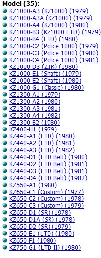

www.kawasakiepc.com/SResultPartIndex.cfm...D=0&PartInfoWindow=1
Opening this link in the Kawasaki.com parts pages will show you which model bikes take the same piston, 42mm. You can do the same for the rear if needed.

Start by going to Kawasaki.com. On left side put cursor over "Owner Information" then on drop down menu click on "Parts Diagrams." The click "Continue" next to "Motorcycles" and click on model/year/etc. on drop down. Ed

Here's a link for help with navigating the kawasaki.com site, and finding information such as parts diagrams, part names, part numbers, models sharing same part, availability, etc.
Click here > kzrider.com/index.php?option=com_kunena&...w&catid=13&id=376734
The part numbers shown for front and rear brake caliper pistons on kawasaki.com do not correspond with the numbers shown at Z1E.
kawasaki.com shows: 43020-1012 and 43020-1011.
Could contact Z1E and ask them about this.
Click here > www.z1enterprises.com/contactinfo.aspx

They actually posted a piston up that will work when I first started asking on here. This is the link:
www.z1enterprises.com/detail.aspx?ID=4734
Like Patton said the part number for the front pistons is 43020-1012. (i believe the rear is 1011)
HOWEVER, I actually ordered them from a different site that was less expensive. Here is the link to where I got them from: www.partsnmore.com/parts/kawasaki/kz1000...ssis&filters=kz1000e
(ok that link didn't work, however if you select your bike, or the kz1000e like mine, on the left and chassis it will come right up. It will show the 43020-1012 reference number)
Fast shipping and the pistons seem to be of good quality! Good luck!
-Phil
