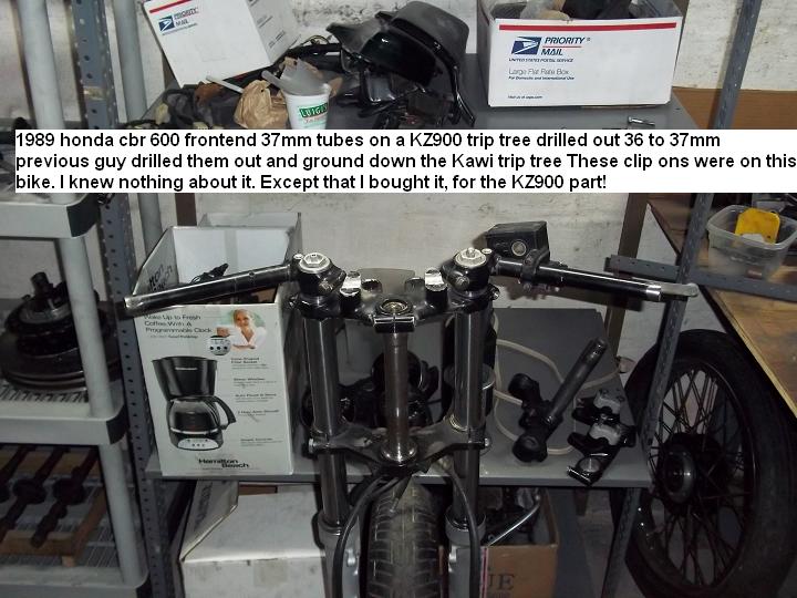

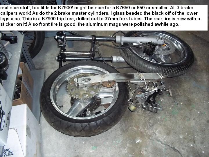

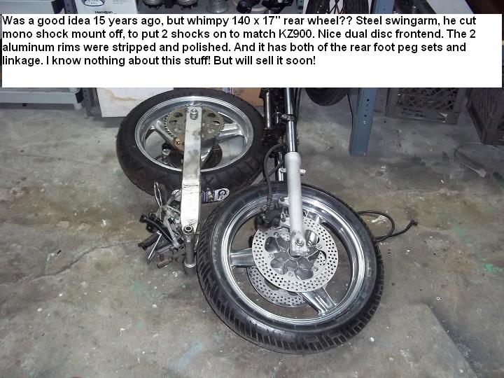

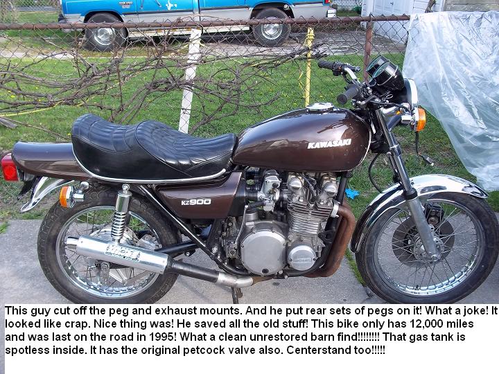

I picked up a 76 KZ900 from Cragslist.
Some Kid was dreamin :laugh: :silly: :pinch: WTF?????
But I have this complete set up from an 1989 Honda CBR 600cc Bike. I have no clue what so ever what it is!!!!! I just bought the bike cause it was a 900 with a title! Plain and Simple!

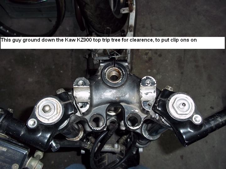

But he went to the trouble of drilling out trip tree's to 37mm for the Honda fork tubes.
And cut the Kaw frame brackets off the rear. Luckilly He saved them. I re-welded them back on.
If anyone has any interest in this whole honda cbr set up Let me know!!!!
Soon or I'll try ebay or scrap it for aluminum at 65 cents a pound!
