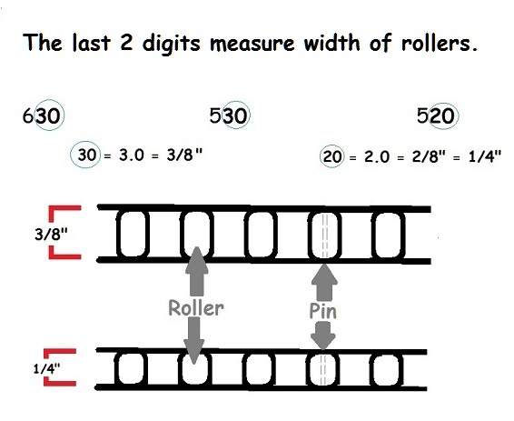

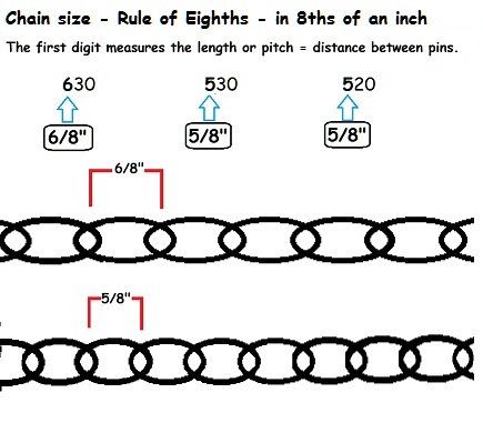

Reducing chain size from 630 or 530 to 520 narrows the overall chain width by 1/8", which provides an additional 1/16" between the chain and tire sidewall.
630 and 530 are each 3/8" wide -- same width.
520 is 1/4" or 2/8" wide -- 1/8" less overall width.
This applies when comparing differences between chains of the same design, such as two different size o'ring chains or two different size x'ring chains.
An o'ring chain or x'ring chain would be wider than the same "size" non-o'ring chain or non-x'ring chain.

The "Secret Handshake" is in understanding how the last two digits manage to combine both decimals and fractions. :ohmy:
