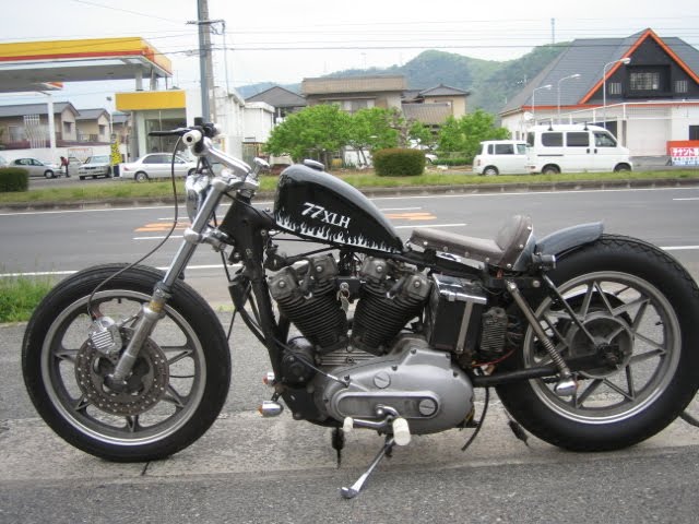

here is a pic tho,
and i don't mean in your whole a$$ :woohoo: !
i'm talkin about right in the ol' bullseye :lol: .
i was talkin to my dad and telling him how much fun it was to ride,except for the bump dealio.
he goes "rigids ride alot better becasue they can flex a little more,it always seems like when you strut a bike it has the struts aimed right for your a.h.
so every bump you hit you feel like you get kicked right in it.
i have a set for my z1r and it is fun to cruise around town like that,but i am always sore on the ride home.
if you have any kinda want to strut your bike i think you should.it is quick and easy to change back to shocks and then you get to tell everyone about your experience running struts.
a sprung seat would take alot of sting outta them i am sure.
i'm all about sacrificing function for speed or style :evil: .
the japanese guys have some sprung struts that look cool and probably keep you from being penetrated :silly: ,but i don't know where to get them.
here is a pic tho,
