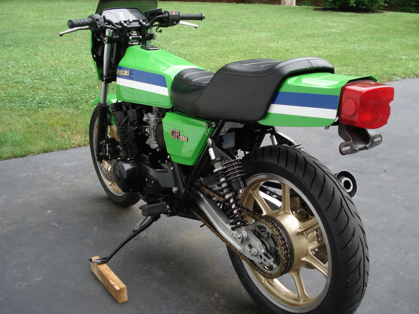

29 Mar 2012 21:07 - 29 Mar 2012 21:09I used an '86 police rear wheel on my GPz550. In the pics it has 120/80-18 Avon AM26. You could probably use a 130, but the 120 was already 10mm wider than the stock 550 tire. The rim is also approx 10mm wider than the stock 2.15. The wheels seem identical, except for the added width of the outer rim. The cush drive and rotor from the 550 bolt-up.
The KZ1000 J model and R models probably had the 2.50 also
