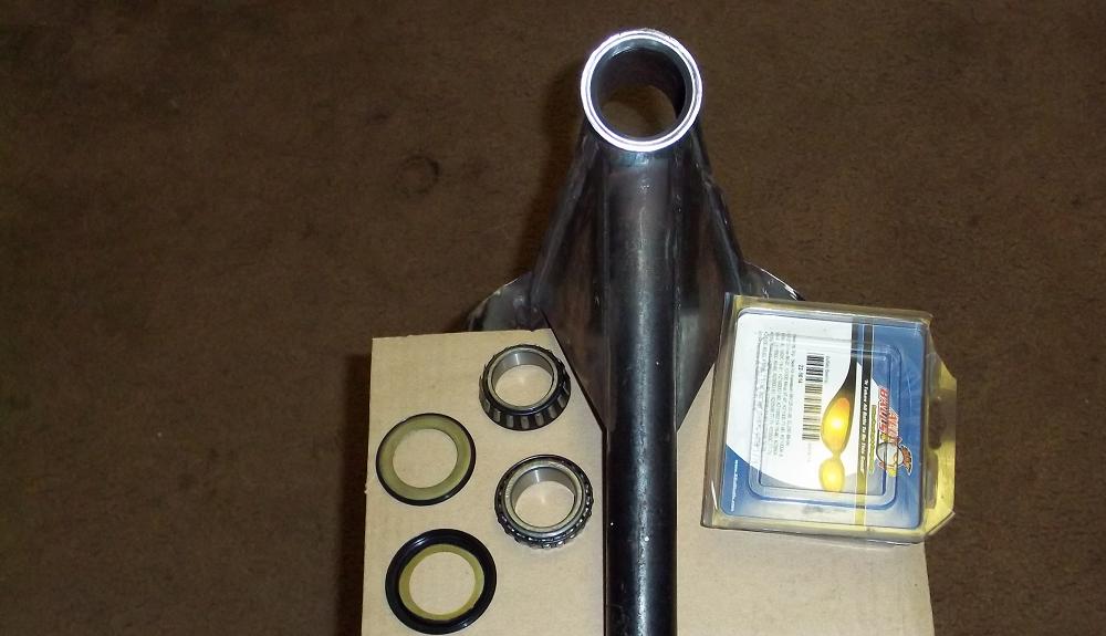

Yes, thats a start. Then use a can of any type of "Brake Clean Solvent" and compressed air.
If the races are good and smooth your good to go, grease em. New KZ set is under $40 on ebay.
I just put a set in a frame last week.
Nothing like them!
Nothing like them!
Last edit: 31 Jan 2012 13:42 by z1kzonly. Reason: add picture

It looks like the bearings and races are fine but it seems that I only have the bottom seal in place, no top seal ???
And I don't think I can get the bottom bearing off with out damaging it.
They use a puller in the manual.
Is that bottom seal under the bearing ?
It looks like it's all rubber, nothing like those beauties in z1kzonly's post.
JD
