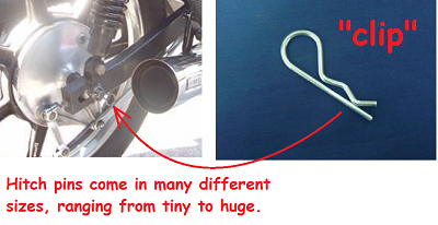

What really makes a difference is using a classy aftermarket hitch pin clip instead of a nasty 'ol cotter key that'll cut-ya!
And Oh-so-quick-and-easy to remove and re-install. Almost makes chain adjustments fun.
Be saying, Wow, hope it needs a chain adjustment! :woohoo:
