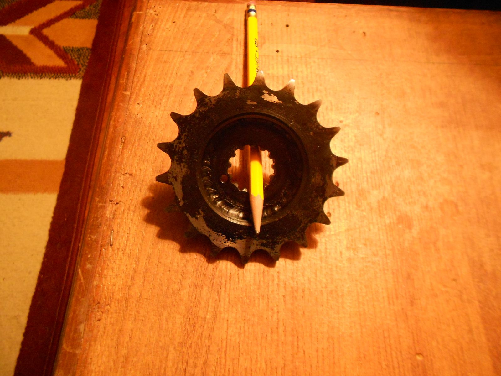

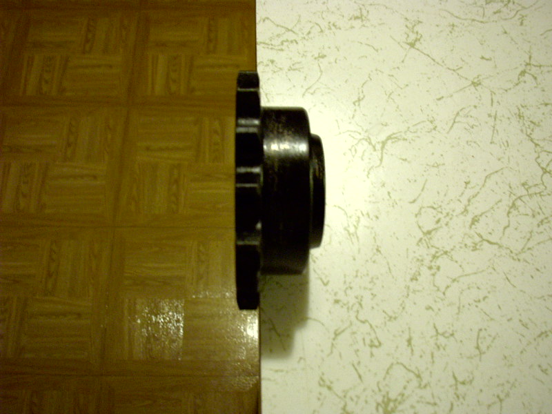

here is a sprocket in progress (5/8's offset) and one finished (3/8's offset).
Attachment kanosfiveeighthsoscs13.JPG not found
and here is the 5/8's finished.

I've cut sprockets for a variety of reasons ( for the steel to make spacers and brackets etc) and only ever used a HSS blade in the hacksaw with no problems ( Maybe i've been lucky ? )
Last one i cut was a JT rear a couple of weeks ago, i machined out the center (with carbide tip) to leave a ring with the teeth on which i used to repair an old worn brit drum .
The discarded JT center was cut up with ease with the hacksaw and recycled.
I will say that i haven't cut an kosman offset though and they do seem to last forever.
I've had one of those on my Z1R for the past 12 years with no sign of wear.

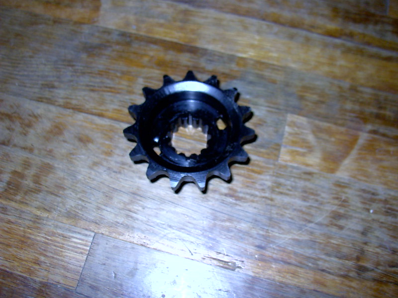

i built an offset sprocket last week.
a carbide bit would not touch them until i heated them redhot and then let them cool.
then i could cut them with a carbide insert,but the material was till very tough.
i ruined one cutting insert and one boring insert getting greedy trying to hurry :sick: .
after i have welded them all back together and they are still red hot i dunk them in used engine oil.
that is what puts the black on them.
i am sure there is better stuff out there to use to harden steel :blush: ,but used oil is free and seems to work fine.
in my experience.
here is a 5/8's oscss
here is a 3/8's oscss next to the 5/8's
here is the 1/2 oscss
