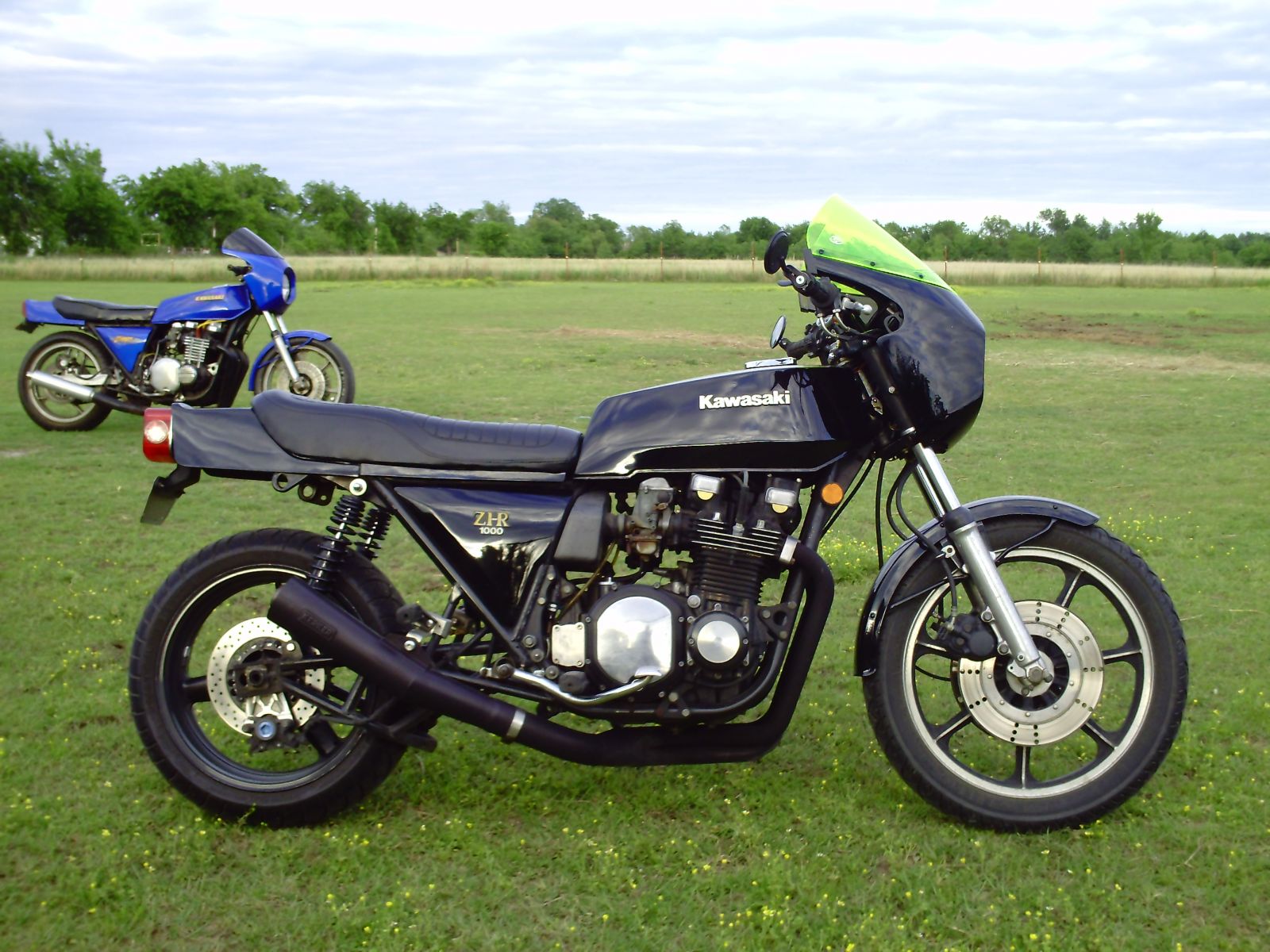

04 Jan 2012 11:41above is my 1980 z1r in it's current configuration.
it is built to suit me and how i use it.
i live 30 minutes from anywhere you want to be,2 1/2 miles off the side of a highway with a 70mph speed limit.most folks run 75-80.
i have no need for a stoplight to stoplight brawler.
i need a bike that can set at 100 mph for an hour with no problems.
18/38 gear ratio 520 chain.
stock frontend.
custom built my own swingarm to house a 6 1/2 inch wide rear 17" wheel from a 2000 r1 with (currently) a 190 mm wide tire.
it handles like a dream.
we have crap roads and with my stock swingarm and 120 wide rear tire i could be cranked over in a 70mph corner and hit some bumps and it would skip into the next lane.
my wife loves to ride behind me and she also loves for me to stuff it through corners as fast as we can safely make it.
so i modified my bike the way i thought it should be and am very satisfied with the results.
i have a late model gsxr front end and mono block brakes with a matching r1 front wheel to install, and just hope when i convert it that i don't spoil the current handling.
stock swingarms flex,skinny tires lose grip.
come ride with me and i can show you how to check for yourself. :evil: :whistle: :lol:
here is a kz650 swingarm that i under braced for t-dub.
[/img] lh3.googleusercontent.com/-Gkkh81NGT_E/T...0%2525282%252529.JPG [img]
in my opinion if you are going to push it in corners you need to at least brace the swingarm and run a softer tire.
thats my .02,ymmv.

personaly, i think 1 of leons additions to your stock arm is the best way to go. specialy if u want a period look. i just dont see how an aluminum square box are looks as good as a round tube arm on a kz.
a brased stock arm gives u both, forrm , and function.
Leon , please dont take this as a put down, because i think u do awesome work.
i think if u made the top main arm on your z1r arm, out of bigger tubing(stock diameter) it would look even more killer than it does now.
