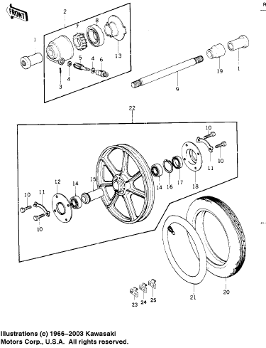

Can someone please post a shot of the diagram for the front wheel assembly for an 1980 KZ1000 LTD or similar models. :whistle:

badrhino wrote: Can someone please post a shot of the diagram for the front wheel assembly for an 1980 KZ1000 LTD or similar models. :whistle: Thanks!

Only seeing the #16 snap ring, but wouldn't bet the farm based solely on this diagram.

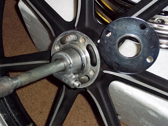

I was pretty much just wanting to know what all held the speedo drive (sleeve) on and as the diagrams and pic show it is just sitting inside the wheel cap that covers the disc rotor. That is how I put it back together but was just wanting to make sure.

That's it. it just sits there under that 4 bolt hole, chrome cover that covers the disc.
The axle holds em in place.
