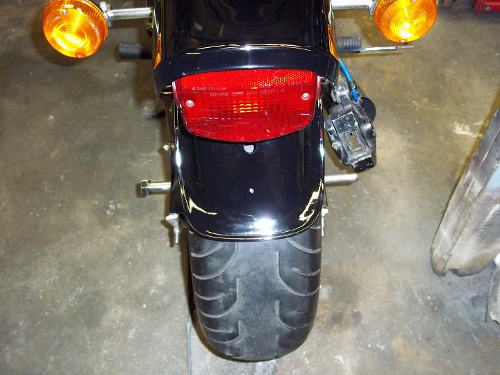

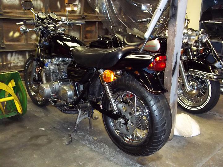

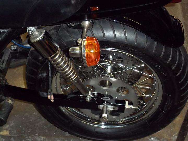

I had this one up for sale for a while. I finally got around to working on it.
This is an 18" x 5.00" Harley wheel with a 200 series tire. Just piecin it together. Making spacers this is a stainless axle. Might lwer it with solid struts. I like old school drag bike look!
Just love starin at it!
