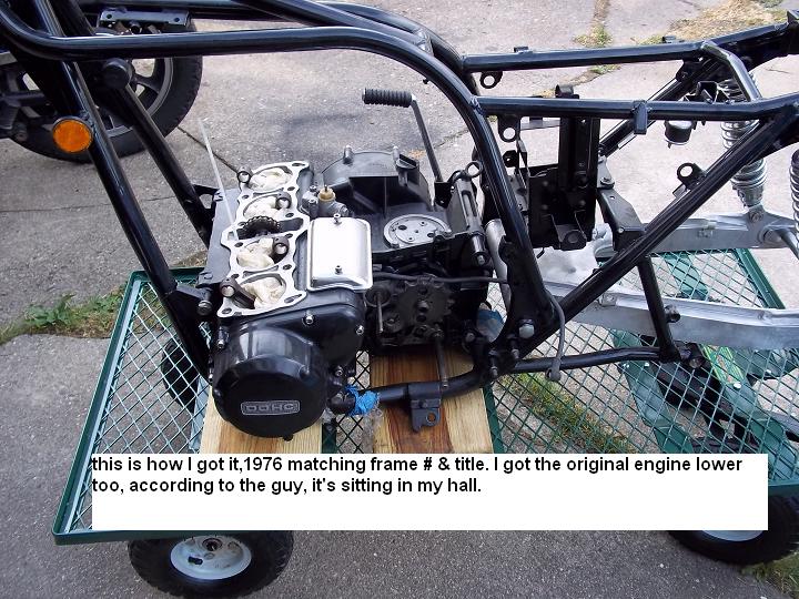

I have a stock 1976 KZ900 frame with title.

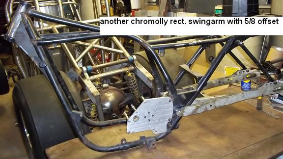

And a 1977-8 kz1000 raked out with rectagal. strut swingarm I am fininishg up.

is that the frame you are selling in the first pic? How much? I really like the swing arm conversion.

I got rid of that Suzuki swing arm and shock deal 12 days ago on ebay. That frame is a stock 76 KZ900 with Ohio Title. It is powdercoated. I am puting the stock swingarm and frontend together with it. And a set of wheels. I want a $1000 for all the parts that I can come up with. lower end of engie. Have a seat, tail piece, 2 chrome fenders, wiring harness, stock air box, nice frt. master cylinder, nice complete back wheel assembly.
