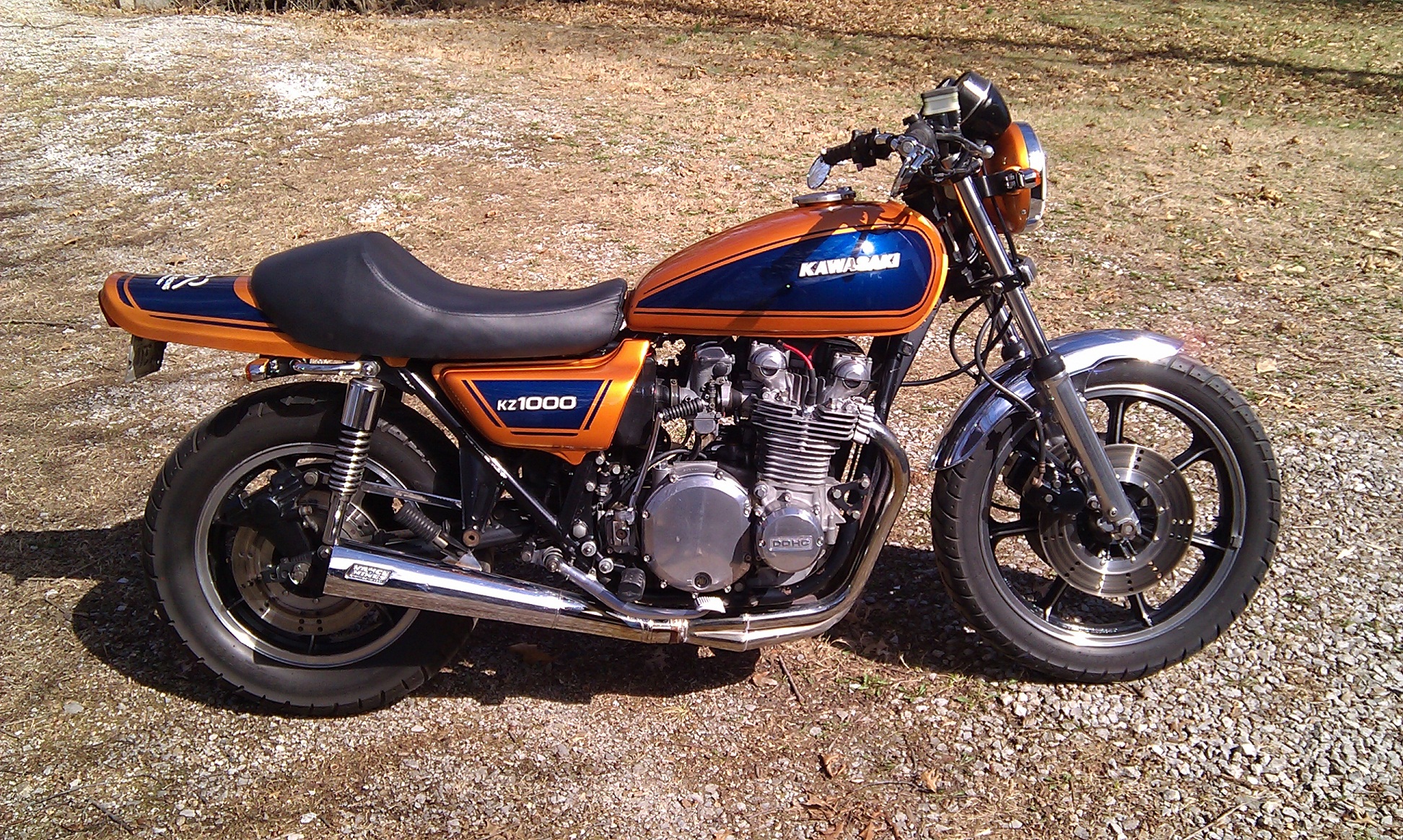

Also,have a look in the KZ1000 gallery for a few ideas....

That's the kind of stuff I needed to hear - and the picture tells a thousand words - thanks.
I did try doing Google searches for pics, but the thing is I didn't really know what I was looking at. Yep, a bike may have great looking bars, but what the heck are they ? I'm a bit of a novice to bikes, so whilst it may be easy to some, I'm hopeless.
Interesting to hear able shortening cables and moving master cylinders etc.....wasn't sure how much of an issue that would be. martin_csr......that is the exact look I was after, and I think that would suit my riding position as well. Thanks again for the pic. I know what to keep an eye out for now.
