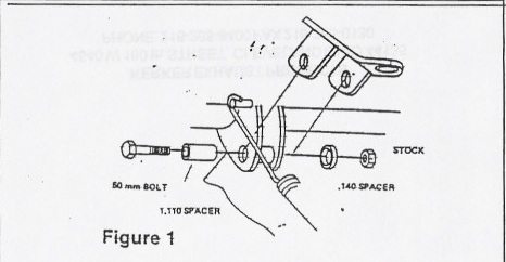

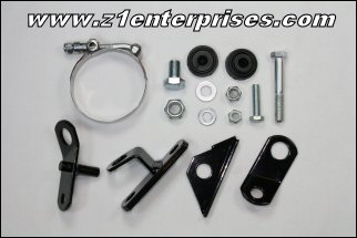

I helped a friend this weekend to install a new centerstand that he got from Z1E. Can any of you remember if the Kerker hardware kit includes a stop for the centerstand? I thought it did but here is what he has....can any of these be used (see picture below)? I will also include a second picture that shows how a similar bracket is used on the GPZ550 model. Will one of these brackets work like this on the KZ1000? I can't find Kerker instructions anywhere for the KZ1000 and his are gone, but he did save all of the hardware. Thanks!
Included hardware from Kerker:
Kerker Instructios for center stand stop on the GPZ550:

You have the piece in the kit, its the triangle shaped plate. It bolts to the inside of the center stand mounting bolts. The others are brackets for hanging the megaphone.

etbike3135 wrote: You have the piece in the kit, its the triangle shaped plate. It bolts to the inside of the center stand mounting bolts. The others are brackets for hanging the megaphone.
That's exactly what I was hoping for. Can't wait to try it out, thanks! I'll try to post a picture of it for those souls as lost as me... :lol:

My friend finally got around to installing his new centerstand today...got a new stand, bolts and spring from Z1E. The stop supplied with the kerker looks like it will work really well. Here's the problem..........WE CAN'T GET THAT FLIPPIN' SPRING ON!!! :lol:
