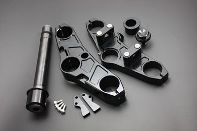

i read and reread these post and i see nothing about the bearings on a swap help me out u guys im putting 85-6-7 frontend on my 81 kz and i would like some help on the bearing swap or advice or even some of you out there that may have done i plan on swapping front and rear from same donor to same KZ HELP!! thanks in advance

I swapped the stems and used tapered roller for KZ. Some guys have custom stems made.

Making KZ stem fit ZX7 lower clamp. Bushing made from the 7 stem fixed that.
Making stem fit to ZX7 clamp - hole was smaller than stem.
Shaved 5mm off bottom of top clamp stem boss to get some ride height back. Allowed clamp to move down further...that allowed forks to drop same distance.... 5mm is 5mm
