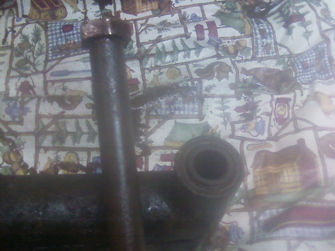

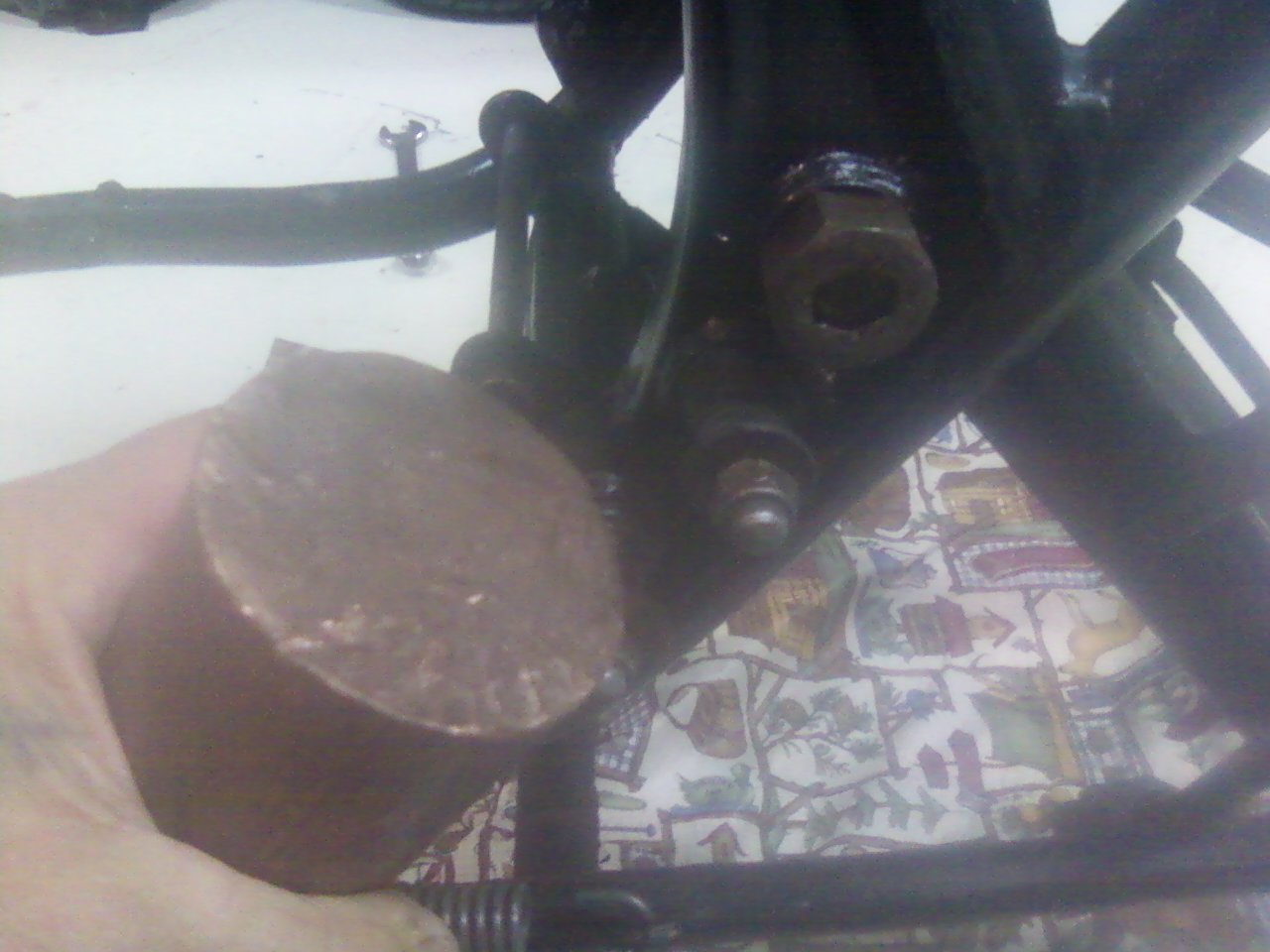

29 Nov 2011 23:45 - 30 Nov 2011 22:27I got that sucker !
3 1/2 days later , thank you Zep 45
At first all I could get was about a 1/8 inch turn on the shaft back and forth
The next day I got the shaft to spin, then I started pounding on the nut with hunk of brass.
Trashed the nut but I was able to get it to move about 1/8 inch back and forth .
today I started to get more aggressive, that worked.
when I needed a drive pin ,I looked around and found a huge landscaping nail, that worked well.
It was a lot of pounding out and taping back in and it finally came out.
What a mess, I'm glad I did it, I need to replace the shaft,nut, needle bearings,sleeve
Folks grease those swing arms.
Sorry about the crappy pics. :blush:

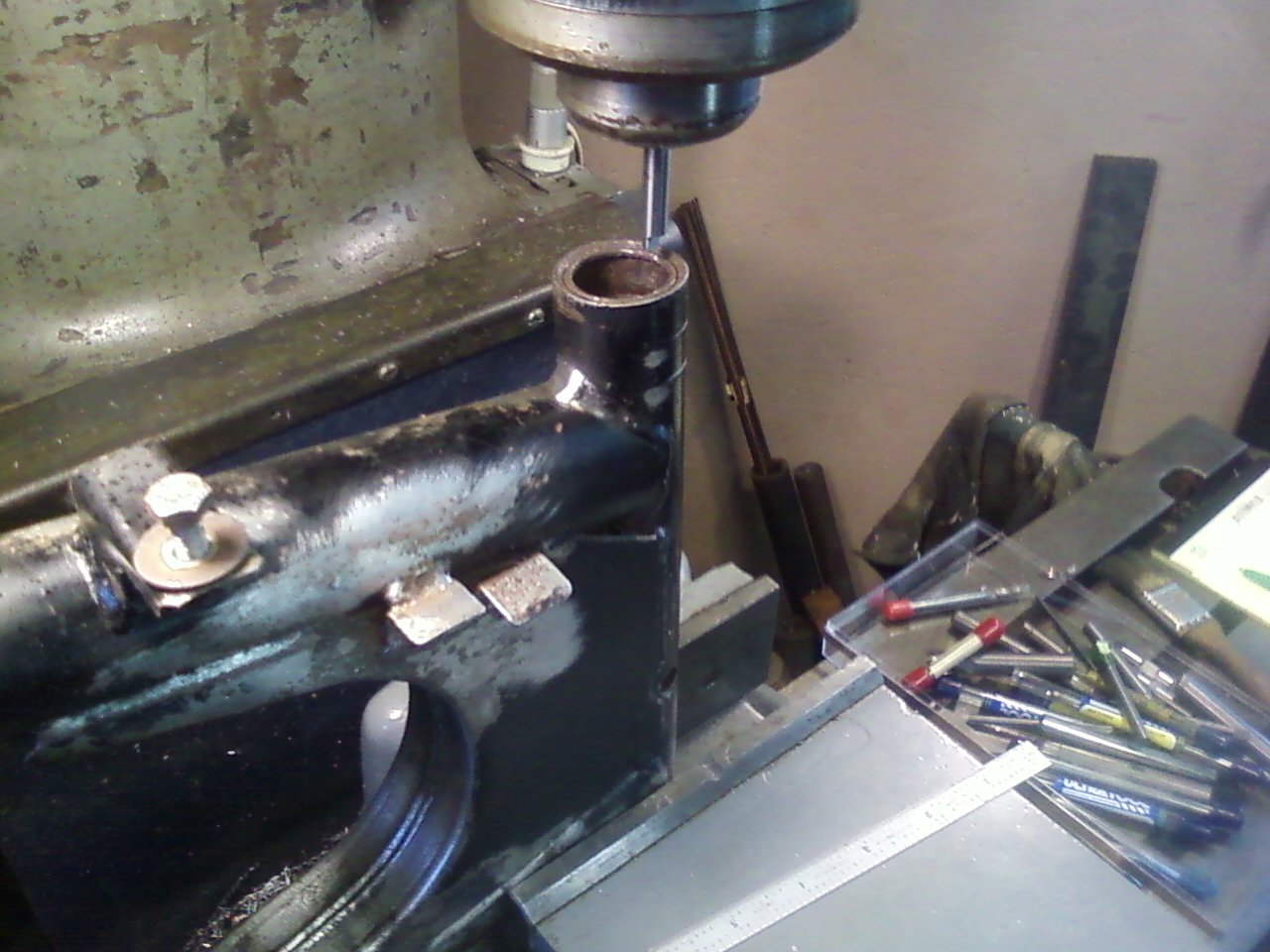

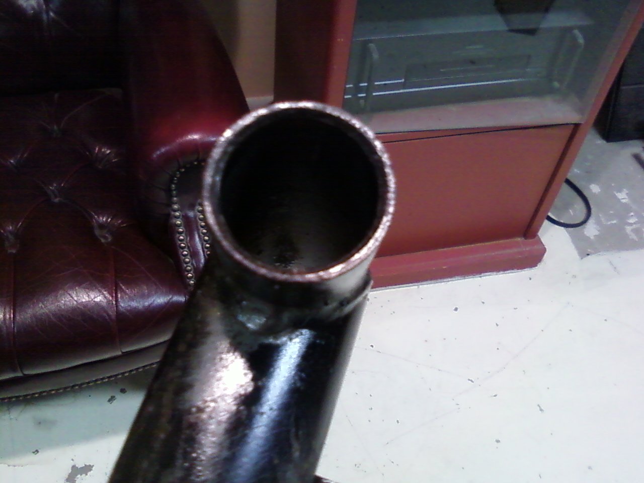

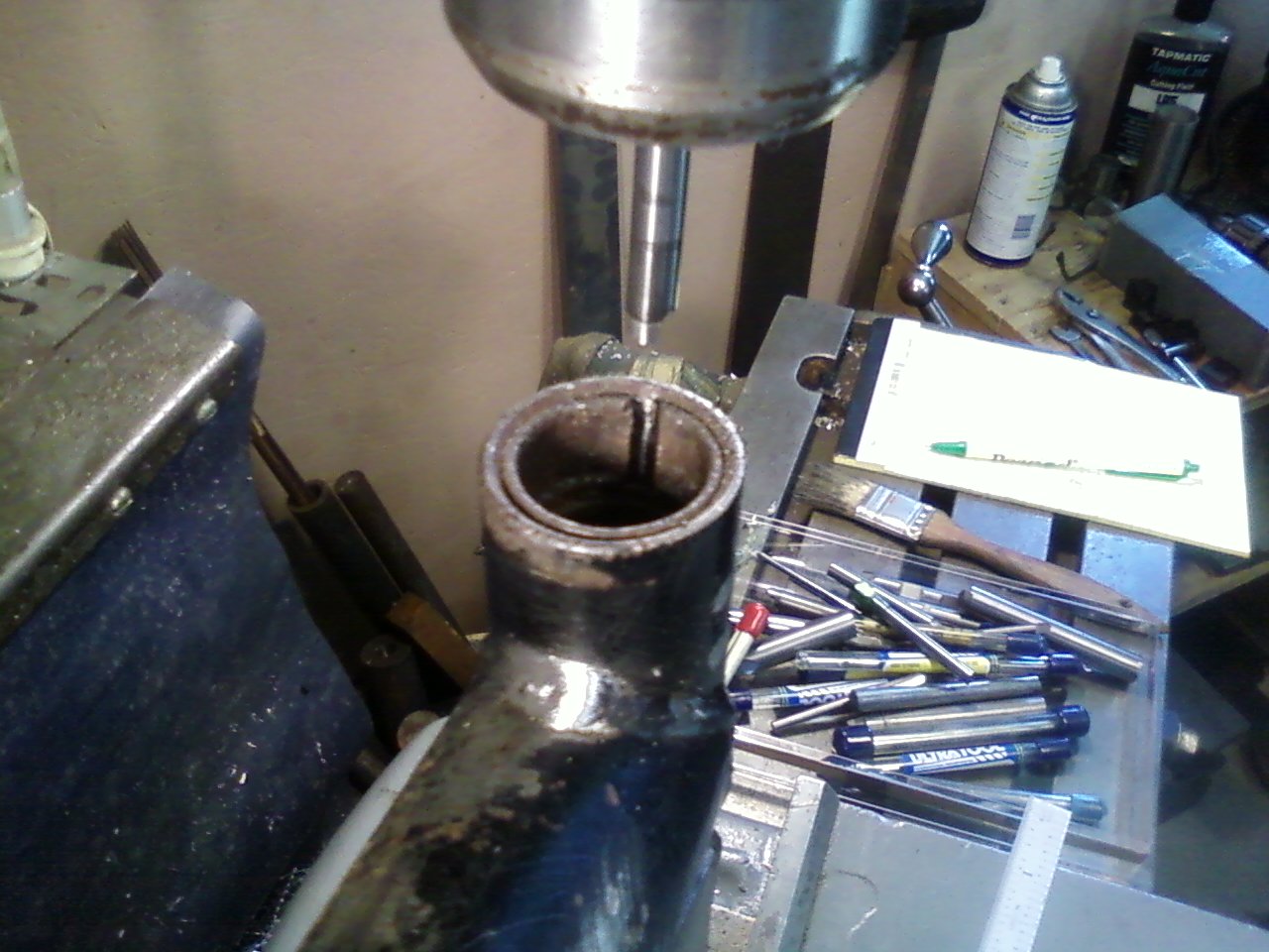

Well the races did not want to come out, but luckily I have a good friend that knows his way around a machine shop.
He was able to cut them out with a carbide bit.
Thanks Tom.
The race is hardened steel, after he made his cuts on both sides ( being careful not to cut into the shaft) they cracked out pretty easily.
Everything looks good
, on to the next butt rash :huh:
