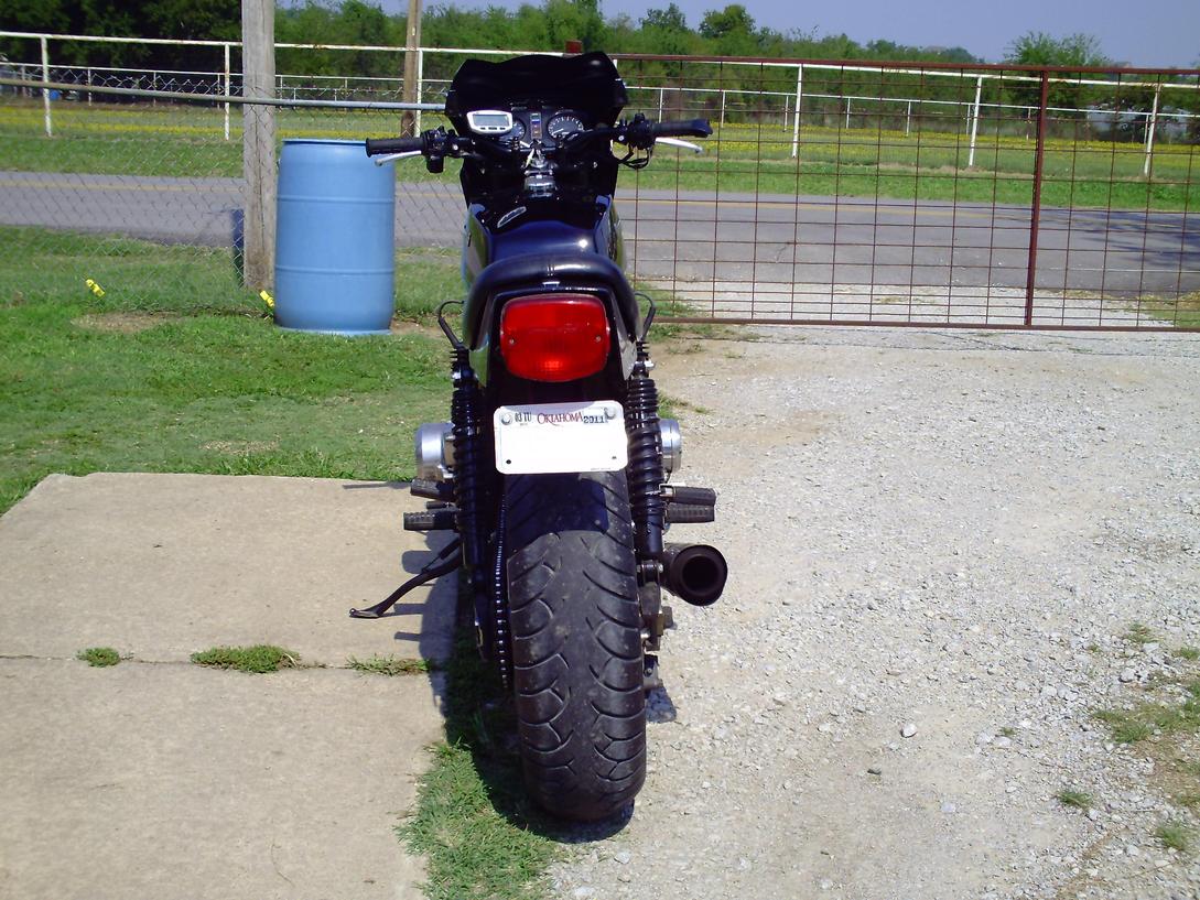

i have gone from 630 to 520 on my 80 z1r and have no regrets.
i fab my own offset front sprockets and
www.pmpsprockets.com/
builds the rear sprockets for me to fit the 00 r1 wheel i use.

- Posts: 7442
Re: KZ 750 Twin, 520 Chain Conversion
21 Nov 2011 19:24
you should not need an offset front sprocket.
i have to have one because i am running a 190/200 mm wide rear tire.

23 Nov 2011 10:46531blackbanshee wrote: you should not need an offset front sprocket.
Bloody hell, well that explains alot! Feck me thats a large rear tyre!
