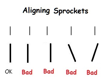

If not already done. would assure rear wheel is properly aligned in the swing arm by using the two chain adjusters.
Don't rely on the indicator marks.
Measure the distance on both sides to assure they are exactly the same from centerpoint of the swing arm bolt to centerpoint of the rear axle.
When completed, the drive chain should leave the rear sprocket and mount the countershaft sprocket without any noticeable turn in the full length of the chain when sighting down the chain over the rear sprocket to the countershaft sprocket.
To assure the swing arm isn't warped (such as one side being higher than the other), it may be necessary to remove the swing arm and place it on a flat surface.
Bottom line -- When assembled, both the rear sprocket and the countershaft sprocket must be in the exact same geometric plane (see illustration below).
Good Fortune! :)
