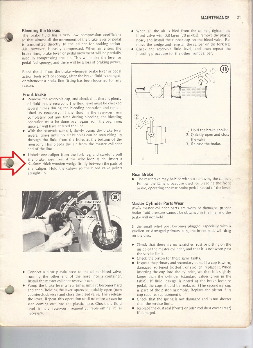

- Posts: 18564
- Thanks: 2103
Re: front brake bleeding
11 Oct 2011 22:39 - 11 Oct 2011 22:43From the FSM:big al wrote: I am having trouble bleeding the brakes on my 1976 kz900ltd. it has dual front discs and i can't seem to bleed them properly.
