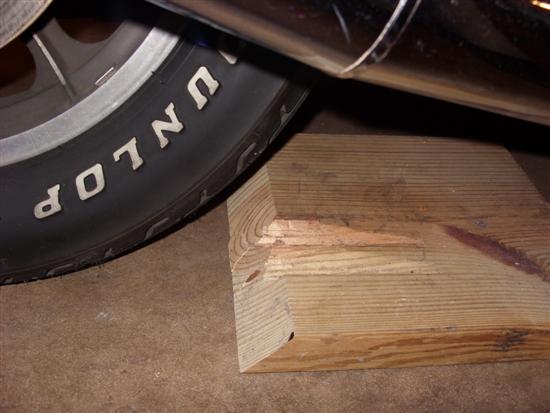

And when using a center stand to lift an LTD, it's a piece of cake when a suitable plank is first placed under the rear tire.
Here's mine just before rolling the bike forward whereby the rear tire rests on the plank.
When on the center stand, the plank may be easily kicked away from underneath the tire.
This is especially useful when the center stand is "too long" for the bike, as where using a Z1 center stand to lift a KZ900 LTD.
Kawasaki did not equip the KZ900 with a center stand. However, the mounting tabs were continued on the frame.
