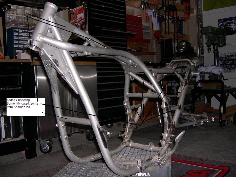

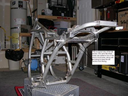

Typically braces are added in the coil area to triangulate the backbone and secondary tubes there, extra bracing is added in the V just above the swing arm pivot, if you dump the air box, a cross brace can be put in there, and sometimes a tube between the top shock mounts out back. I thought I had some pics, but cannot find them.

These pics are of a Z frame, but you can get the jist of it...

Tex, thanks for the info, i appreciate it. It looks as if i will only need to do the tail section as the coil area and column area are already done on the J model... Save me some time for sure. I will try and snap some shots tomorrow for reference.
