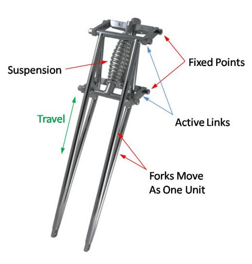

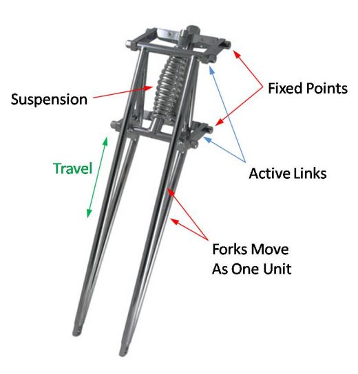

don't weld on your fork tubes.
they are not just tubing.
you need to make sure that you use fork tubes,they are centerless ground and have machine work inside.the easiest thing would be to find a longer front end(250cc or up dirt bike forks have been used)and swap it onto your frontend.
forks by frank can build you new upper legs any length you want.
or get your welder dude to fab you up a girder.
