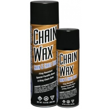

I'd wipe off any excess grease, then start using a high quality lube every 300 - 400 miles. Everyone has a different favorite lube; I have had really good success with Maxima Chain Wax (see pic). Most good cycle shops carry it. BTW, did you replace the sprockets with the chain? If not, the chain will wear out prematurely as it tries to conform to the worn tooth spacing on the sprockets. Ed

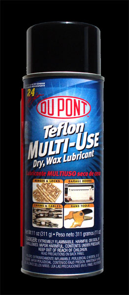

650ed wrote: ...Everyone has a different favorite lube; I have had really good success with Maxima Chain Wax...
Whenever Ed gets around to trying this
he'll throw rocks at Maxima Chain Wax, and have lots of extra money for more important stuff like women and booze and old BSA classics. :cheer:
Good Fortune! :)
  • 650ed
  • 650ed's Avatar
  • Posts: 15334
  • Thanks: 2832
Re: New Chain: Pre-Installation Prep?
22 Sep 2011 22:01
#478805
Money left over for women, booze, and BSA's. OK, I'll give it a try! :woohoo:

The dupont stuff is pure magic. Not only been using it on the chain for four years, my wall unit AC started screaming because the main bearings and fan shafts had rusted up terribly. I saturated them with that dupont stuff and they haven't made a sound in five months.

how bad does it fly off? im using this honda lube stuff right now. lubes ok but what a mess. almost makes me not want to lube chain.where do you buy the dupont stuff?

camaroguy wrote: how bad does it fly off? im using this honda lube stuff right now. lubes ok but what a mess. almost makes me not want to lube chain.where do you buy the dupont stuff?
ZERO fly off. It sprays on with a liquid carrier that penetrates and flows, that evaporates leaving a waxy sheen. There is absolutely no fly off. Buy it at Lowes, I think it's $5 for the big blue can.
