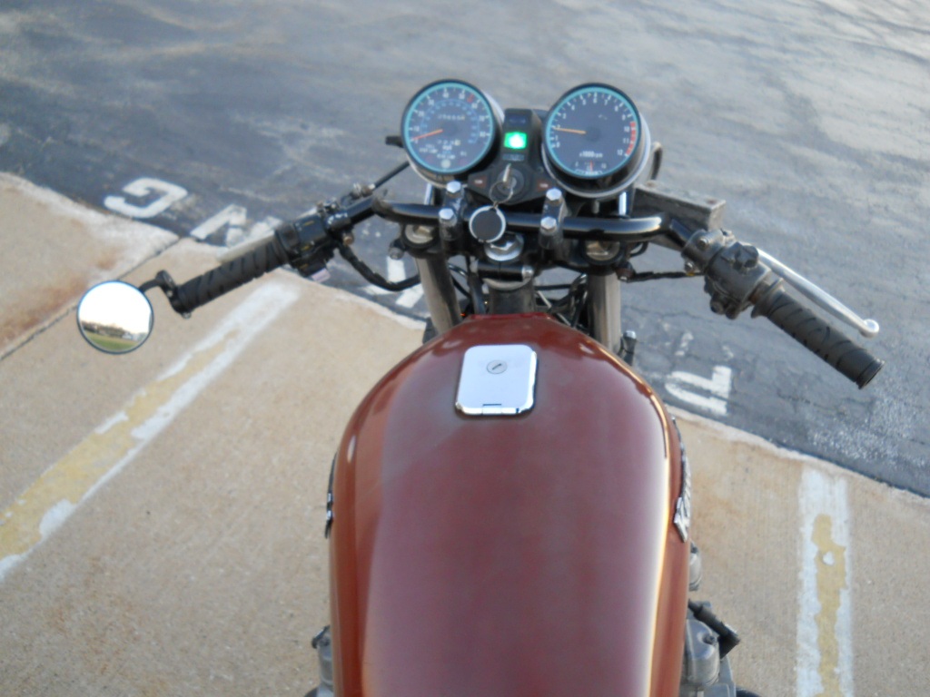

I've got them on my KZ550. Real easy install, took about 20 minutes. I just tucked the extra cable leingths in here and there, routed the clutch and throttle lines around behind the far side of the headlight bucket, brake line makes an S-shape. You'll need different mirrors though. I did bar end and am pretty happy with them!

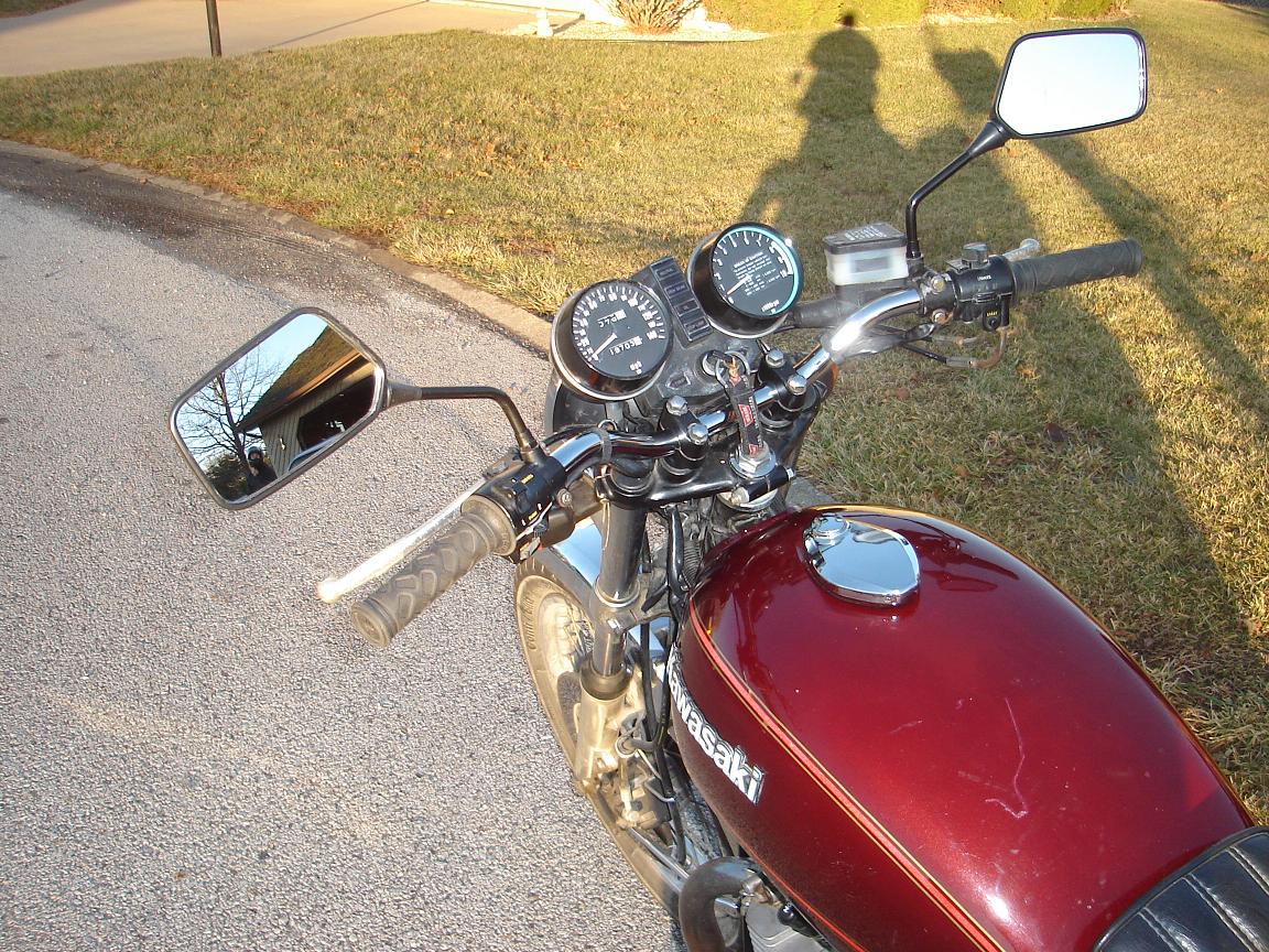

30 Aug 2011 14:59Not a 750 twin but on a 4 cylinder they are a tight fit. Will work with creative hose and cable routing. LTD style master cylinder(angled mount )works.
