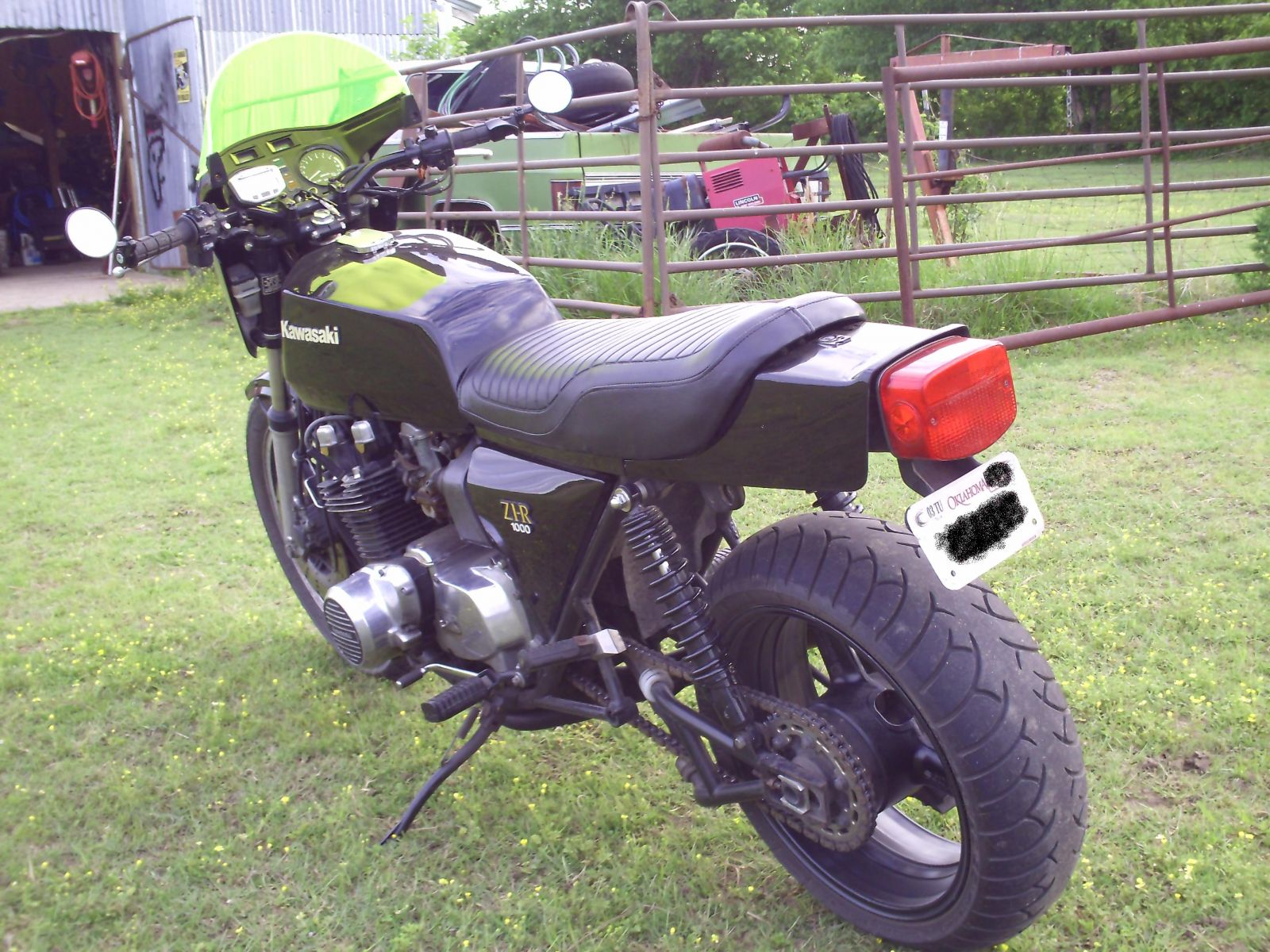

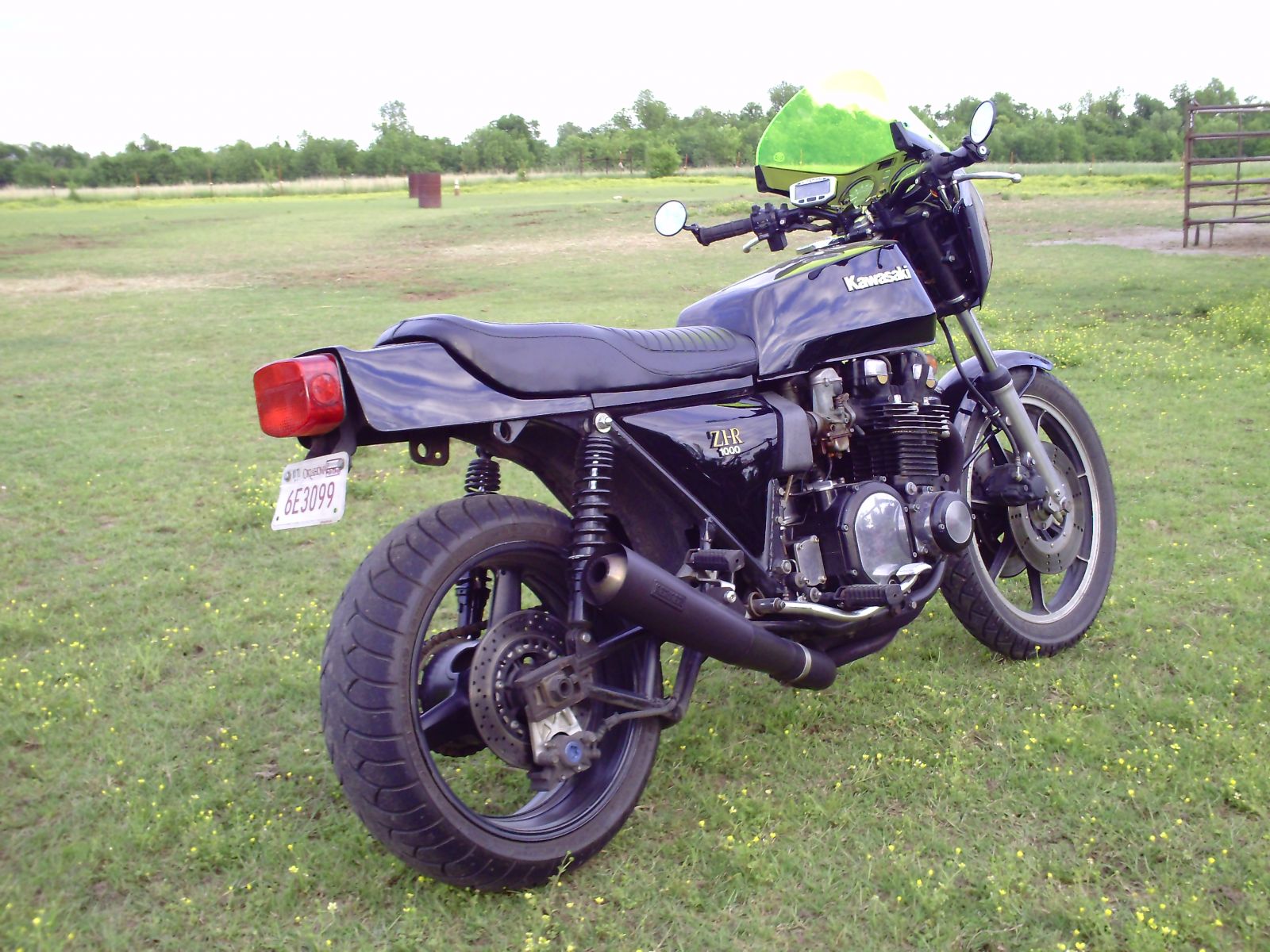

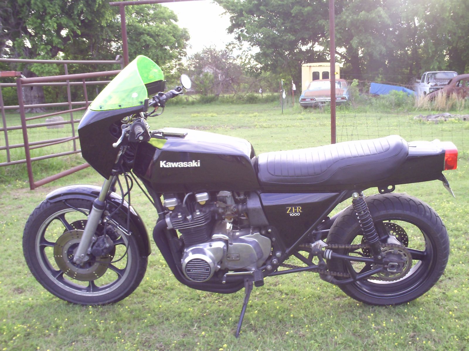

- Posts: 7442
Re: Anyone ever re-covered a Z1R seat?
30 Aug 2011 13:05
these are the best pictures i have of the installed reproduction seat cover.
be careful with the triangle tabs.bend them as little as possible.dont pull on sewn seams(as you will tear the stitching out of the seam,don't ask how i know this :sick: ).
your finger tips will be sore for several days after.
hth,
hth,
