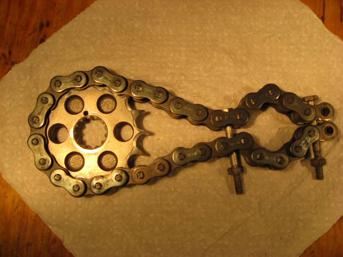

You really should replace both sprockets with the chain. These parts wear together and an old sprocket will prematurely wear out a chain, even though the sprocket has some life left in it. Also, it is important to replace that engine sprocket washer with a new one; they are still available from Kawasaki. Don't take the chance on damaging your new chain using it to hold the sprocket. Use a piece of the old chain as shown below. Just wrap it around the engine sprocket and use 2 long thin bolts to fasten the loose ends to the swingarm pivot. This way there's no stress on the brake either.

That is genius! Thank you thank you thank you!!! :woohoo:
