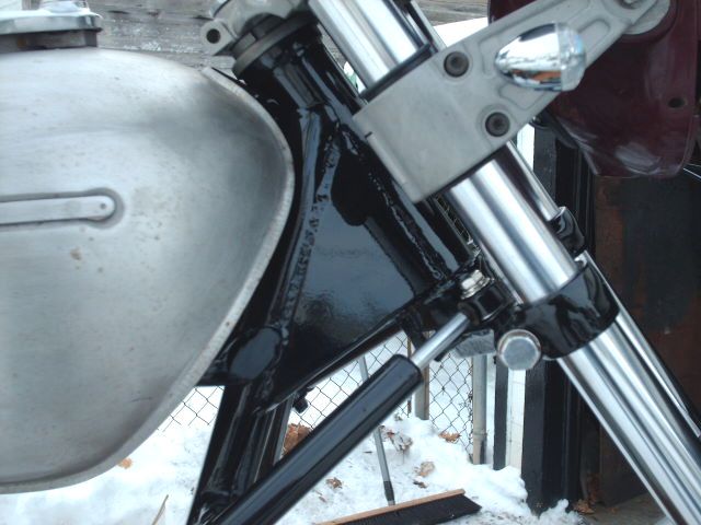

I raked a CBX Honda 6 cyl by cutting the original headset in half vertically, trimming the back top section more than the lower part to achieve the required angle which was 37 degrees and letting in a cleaned up used headset. This way all the original welds to the frame tubes retain their integrity and the new headset is firmly nested into the back half of the original headset tube.Not quite as pretty as some but nice and strong. Wish me luck !!

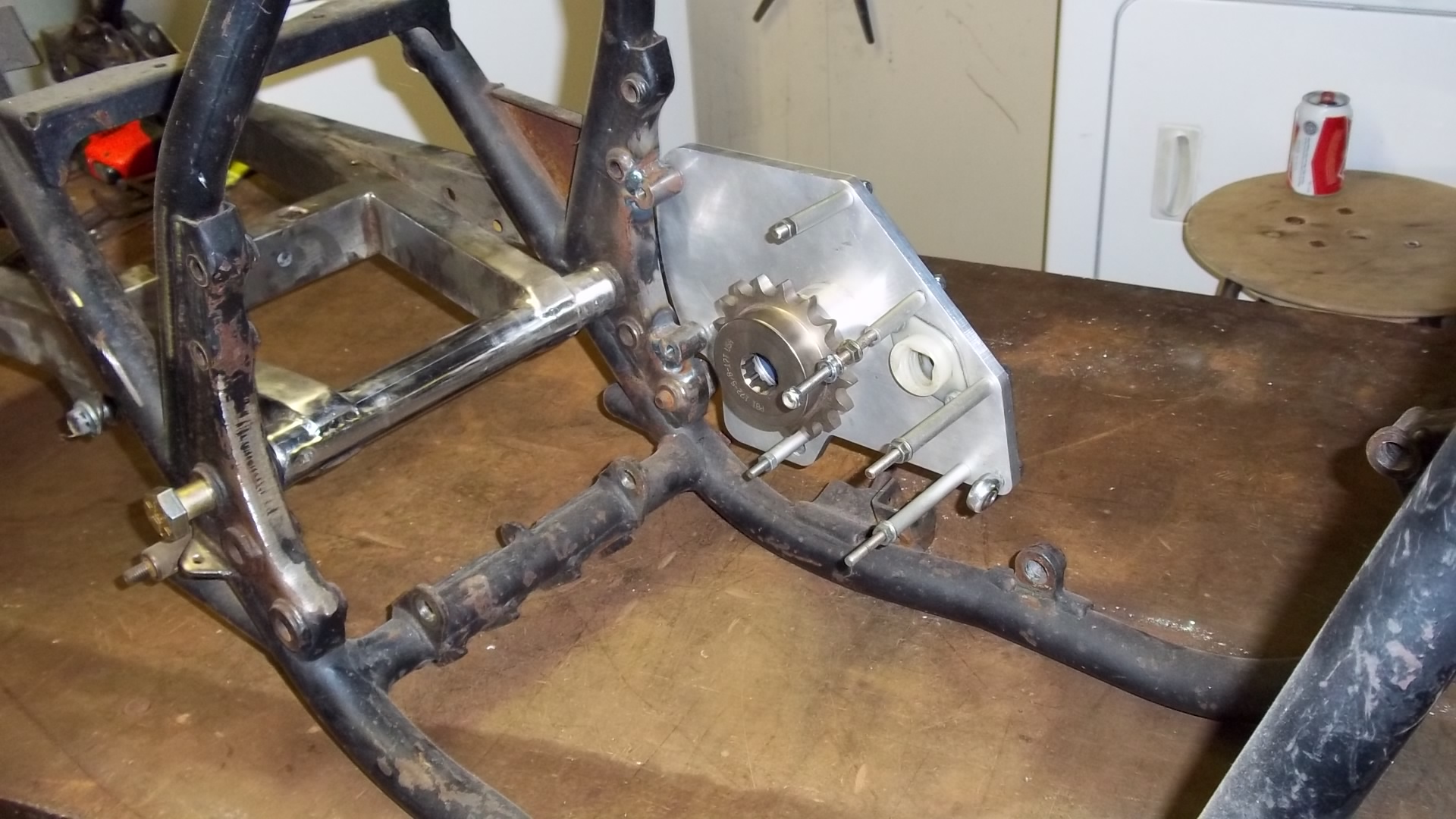

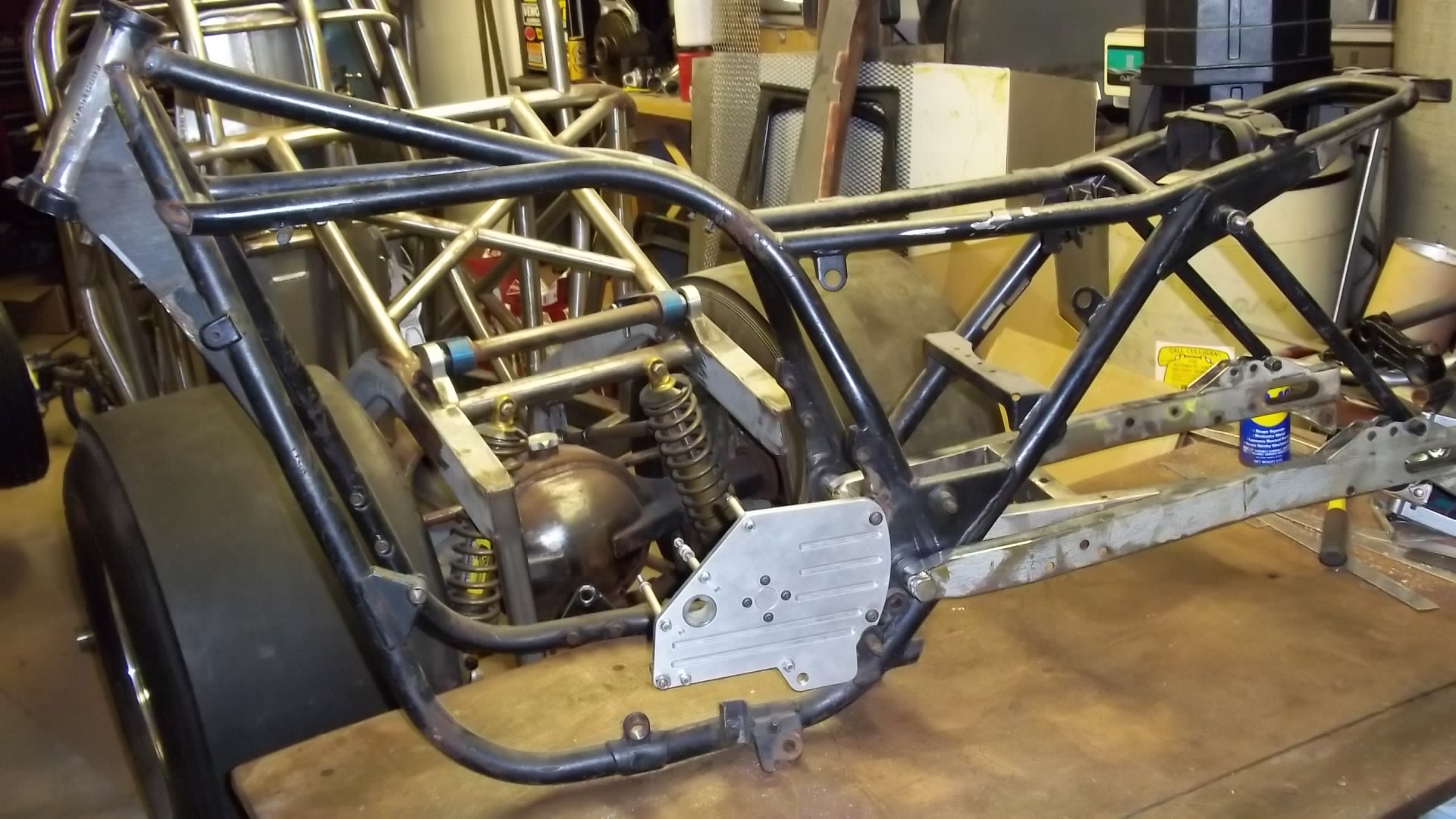

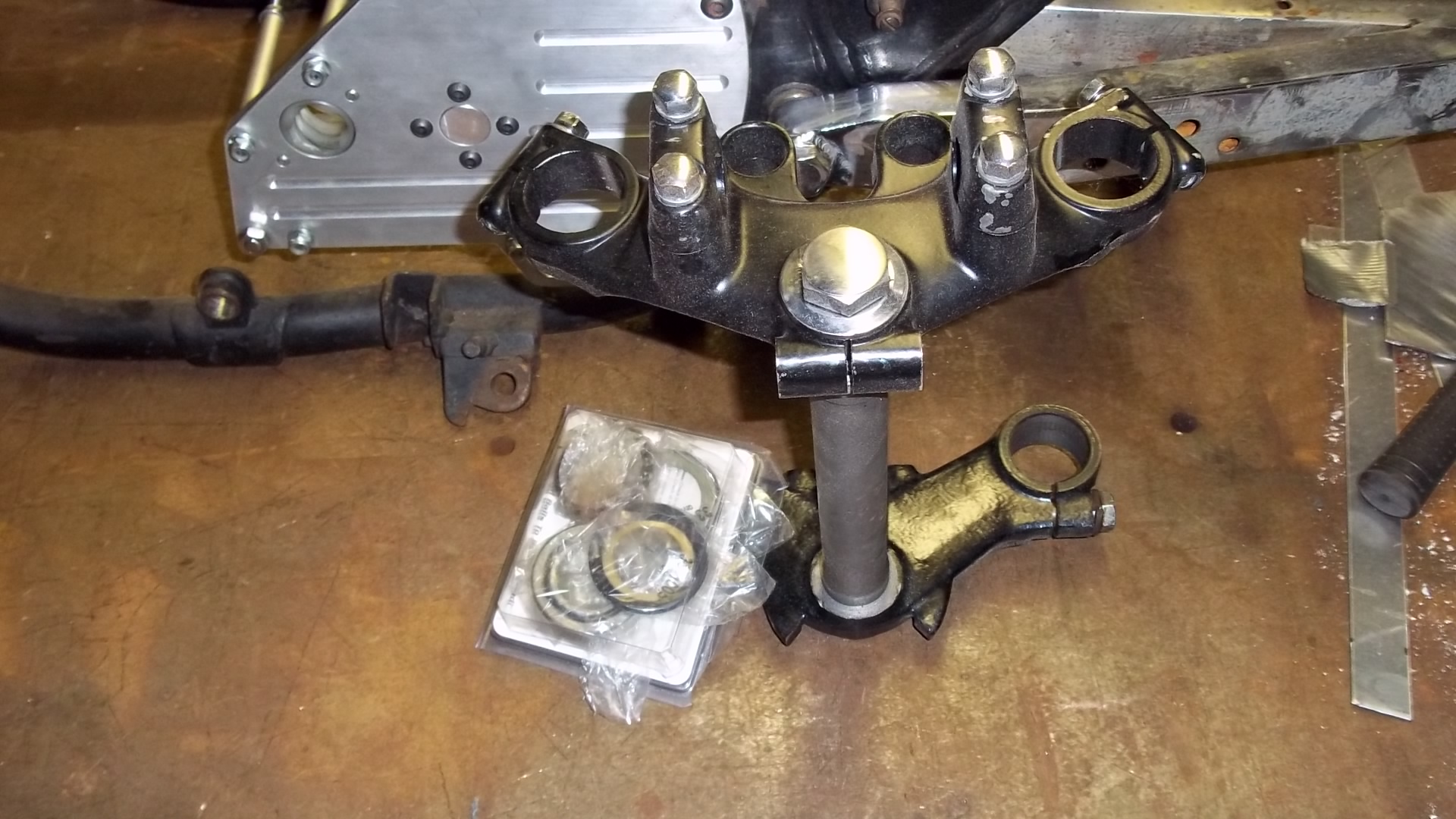

Here is another project, It is for sale.
KZ900 with offset bearing plate from Irishwill.
Chromoly swingarm, with struts, and roller bearings for the neck. It has a NYState title
