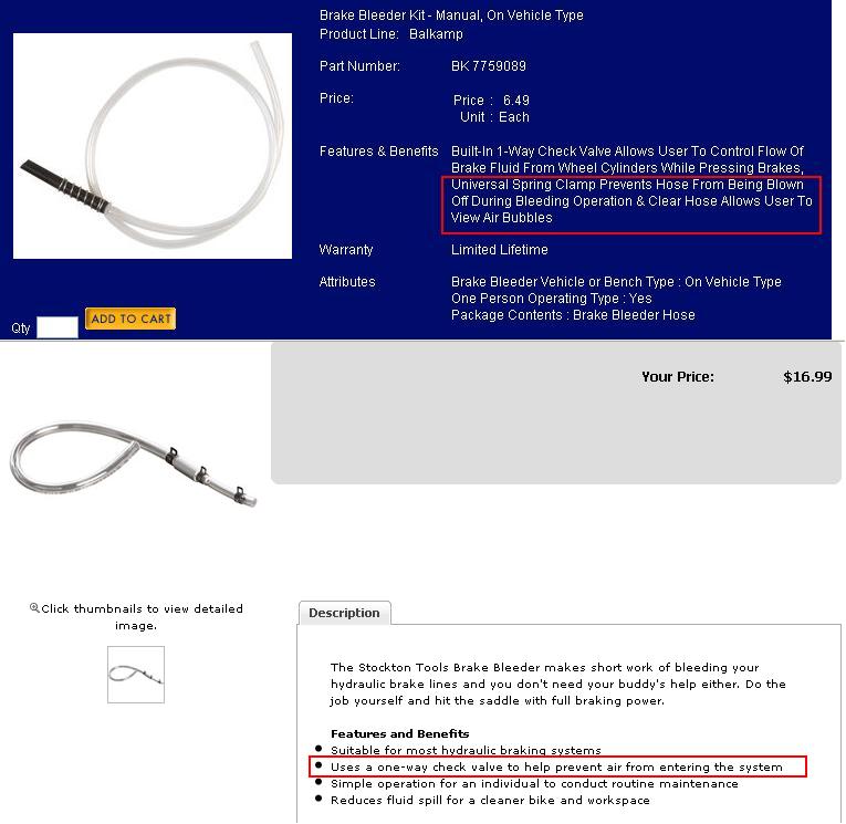

Tim, best little tool I found to bleed brakes... Worth every penny.
The NAPA one worked very well but didn't last long. The bottom image Stockton Tool is from Cyclegear, more durable and works extremely well...

I've used this type for many years:
Brake Line Bleeders
www.speedbleeder.com/size.htm
www.pingelonline.com/brake_bleeder_kit.htm
Brake Line Bleeders
