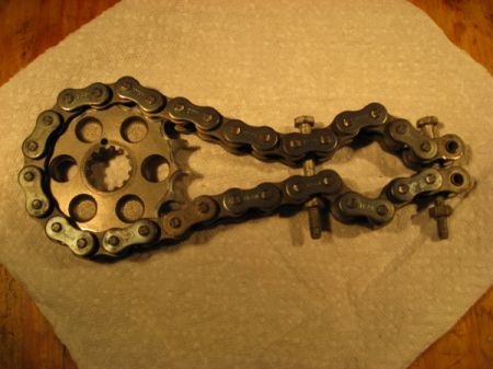

Using an old piece of chain is another possible option for holding the sprocket in position.
