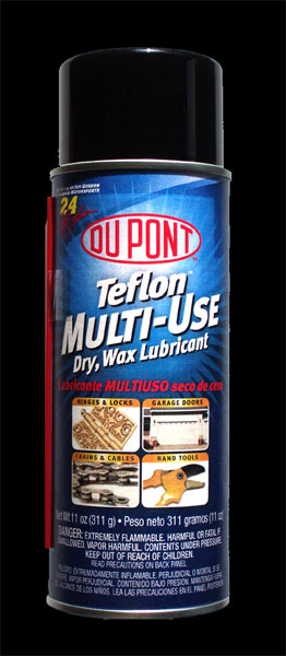

This inexpensive spray chain lube available at Lowes has been doing an excellent job on my bikes and doesn't fling off.
And it's cheap enough to apply liberally as a combo cleaner-lube.
I use it on lots of things, and will likely never again buy another can of over-priced dedicated motorcycle chain lube of whatever brand.

05 Aug 2011 11:58Patton wrote: This inexpensive spray chain lube available at Lowes has been doing an excellent job on my bikes and doesn't fling off.
+1
