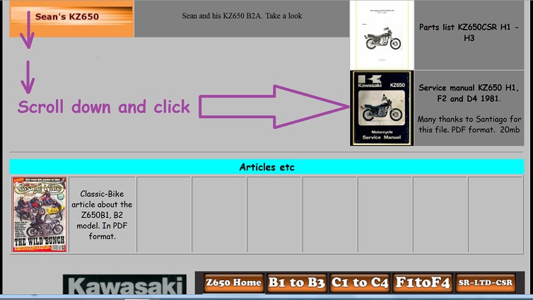

If needed, here's a down-loadable on-line version of the Factory Service Manual (FSM).
Click > jarlef.no/Kawasaki/Series/Z/650/z650files.htm
