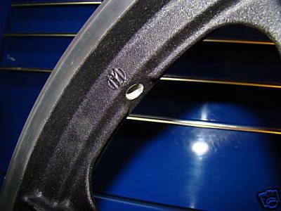

Kapahulu, if you change wheels, save the mags. If they're original, they're made by Morris, and may be worth some $$ to someone. Morris mags have a little "M" inside a circle, somewhere on the rim, I think.

21 Aug 2011 15:55The front and back wheels (spoke) just came in the mail this week. It may take me a few weeks to get these wheels on since there are so many other things to take care of on this KZ.ltdrider wrote:mtbspeedfreak wrote: '76s came with Morris mags, didn't they?
Yep.
Thanks for the tip, I will check the mag wheels.

- Posts: 18564
- Thanks: 2103
Re: KZ900 LTD swapping out dual disc to single disc
21 Aug 2011 16:51Kapahulu wrote: ...Morris mags have a little "M" inside a circle, somewhere on the rim....
