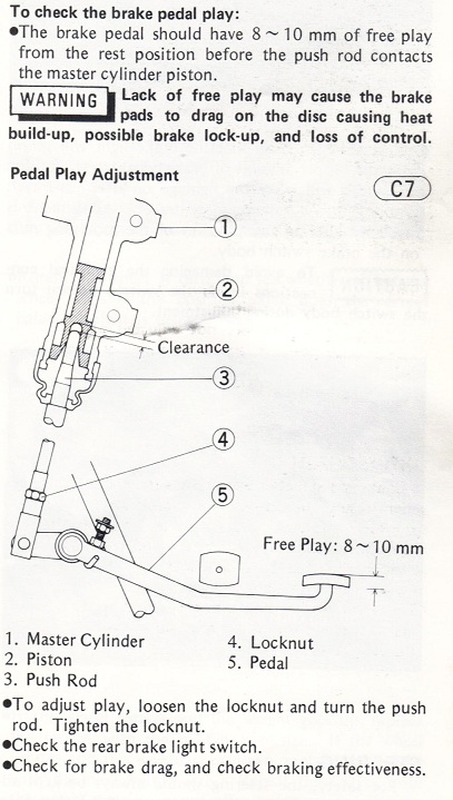

Possibly non-existent or too tight gap in rear brake between end of brake push rod and the master cylinder piston.
This is usually an adjustable item, and is a different adjustment than pedal height.

patton, if you have time could you elaborate a little more about that gap your talking about. im not really understanding what your saying, and im leaning toward the back brake as the problem.

This is how it is on the Z1 and KZ900
Am guessing it's the same or similar on the bike at hand.
