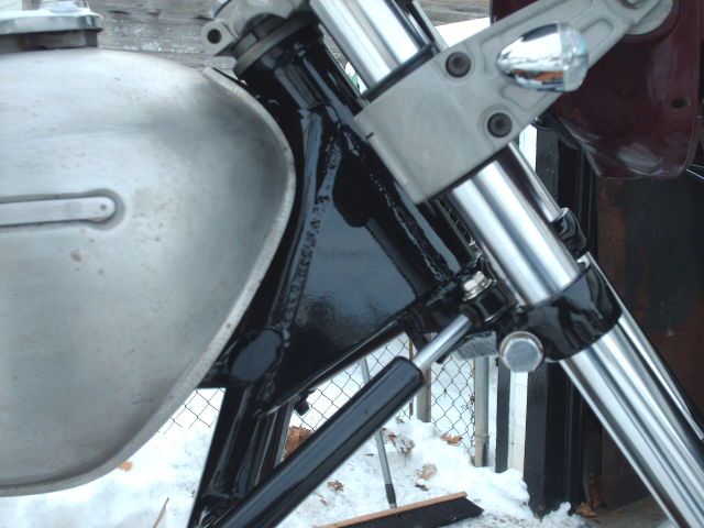

Does anyone know how or what triple tree that will off set/rake the front forks on a kz1000 78-79? I would like to use factory kawasaki parts rim etc. All ideas suggestions and pictures or other riders sites would help. Thanks.

I'm pretty sure the only way to do it is to rake the frame.

The only SAFE way is to rake the frame. Just doing raked trees isn't a safe alternative.

Yes rake it!
Ore try a set of fork legs from a CSR or early 80's Kaw 750 LTD that has the axle out front, up a couple of inches on the fork legs.
You must be using a V/H sidewinder??? Needs rake!
here is a nice rake job picture on a 76 KZ900
