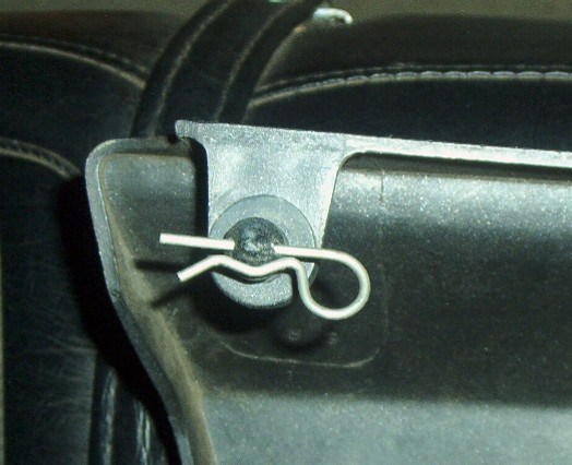

16 Jul 2011 01:57 - 16 Jul 2011 01:57
#463112
Attachment addsig.jpg not found
Good Fortune! :)

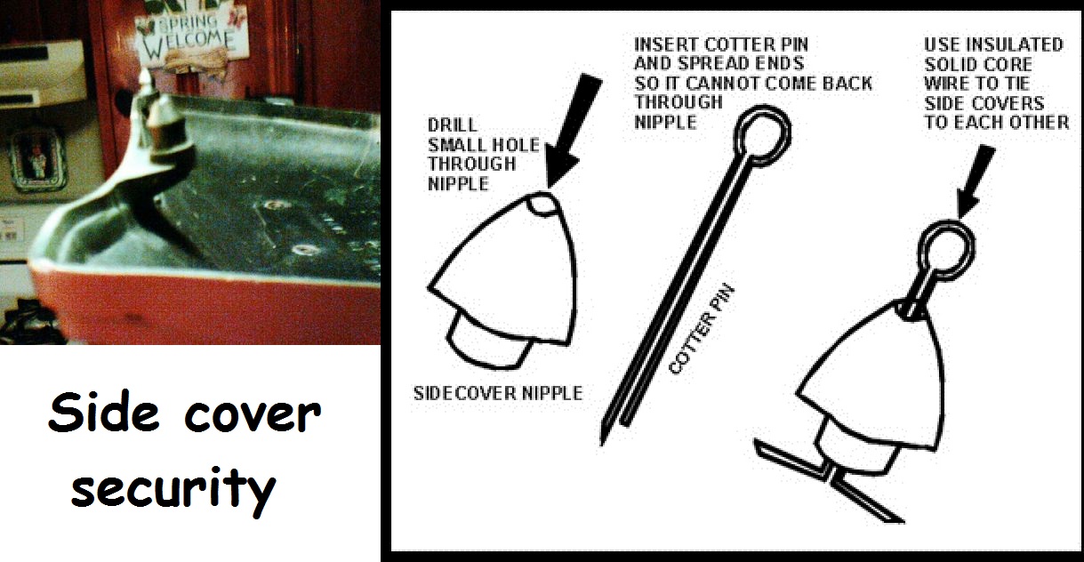

Another security option:
Grommets are relatively inexpensive and easily replaced.
Z1 Enterprises likely lists the new grommets.
Reportedly, using pod air filters may allow more wind pressure underneath the side covers.
