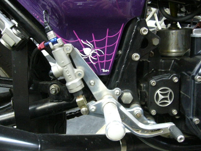

depending on what look youre after you could find a brake pedal/mastercylinder from a 76 900 ltd,or you could use rear sets off a newer sportbike with master cylinder built into it

I have both KZ and Ninja master cylinders so I don’t really have a preference. I did get an idea after looking at some sanctuary pictures. They had some polished up and mounted to the outside of the frame and then hid the reservoir. I’m not sure that will look good on my bike but it is an idea.

'76 900 ltd would work but I don't like the look. On my 79 ltd 1000 the master cylinder is hidden, pretty much. And it is actually only the actuator rod that is in the way, I think.

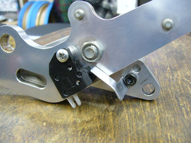

no offense taken on the blue z1r.
here is a simple elegant(to my eyes)solution.
with a micro switch for the brake light.
although as a machinist i do appreciate mechanism's also. :lol:
p.s. welcome,keep us posted.
