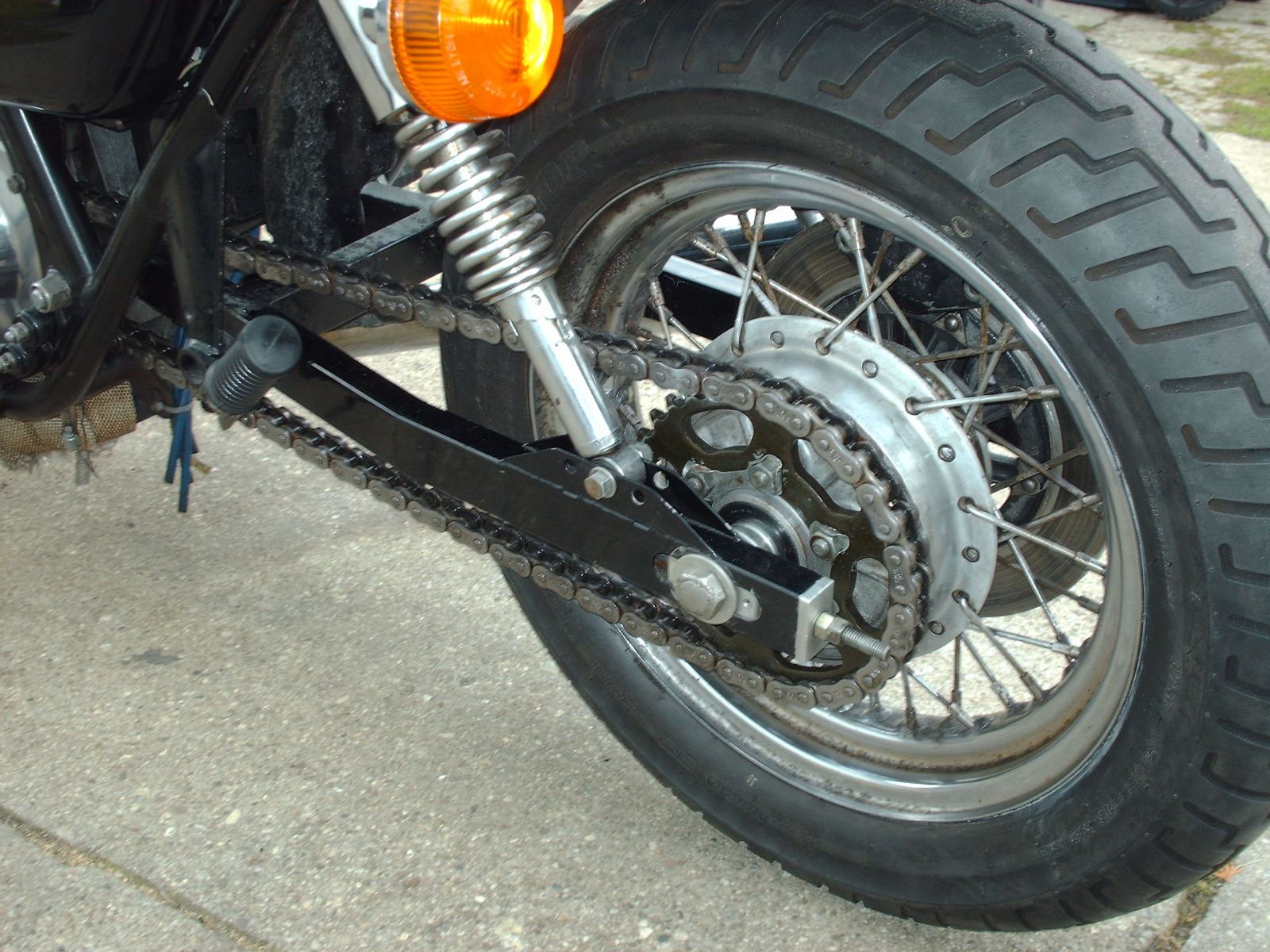

Here's a Suzuki GS on a KZ, and a 3" extended stock KZ900 swing arm with struts.
Attachment 000_0001_1.JPG not found
