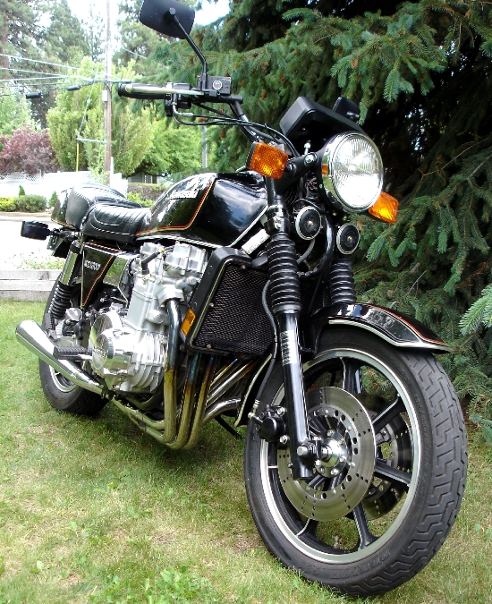

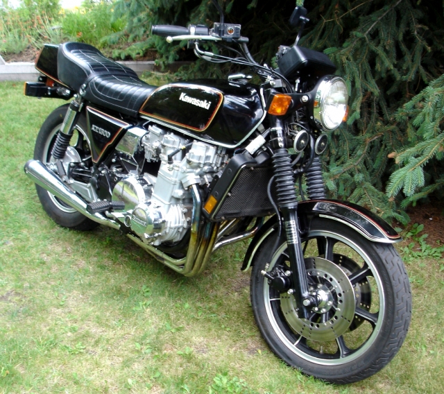

13 Jun 2011 21:11 - 13 Jun 2011 21:22KZCZI has (or had) a handsome KZ1300 with a round headlight.wildman1138 wrote: ...79 kz1300...really want a round headlight....
See several pics in the Gallery.
Here are two of them.
