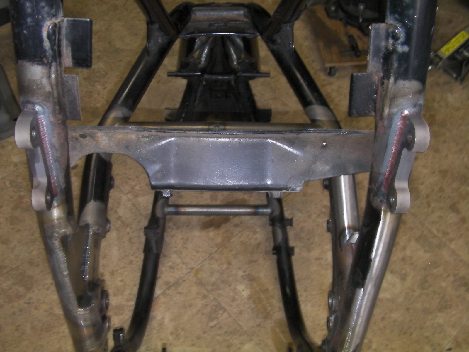

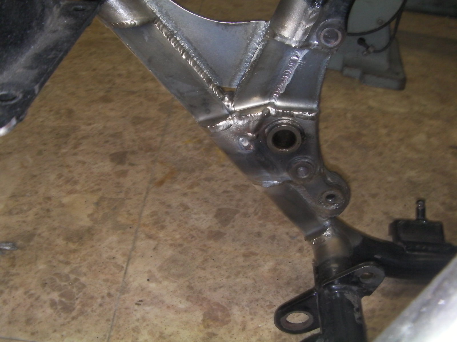

when testarossa talks about some chain clearance here is what it can be like.
on kz1000's anyway :whistle: .

Leon, is that the Z1R frame? I did mine blacksmith style, BFH and torch.

no josh,
that is a sanctuary frame.
